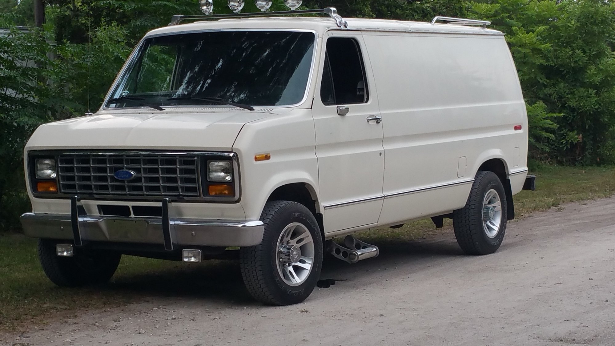

New Toy
I hope this shows up.
It's a 91 E250
It drives great needs some clean up but I hope it pulls the trailer good.
This is what I had to go get in Ocala Florida, 200 miles from me.
I'll still need help with the 94 E150 if you guys don't mind.
Calvin
