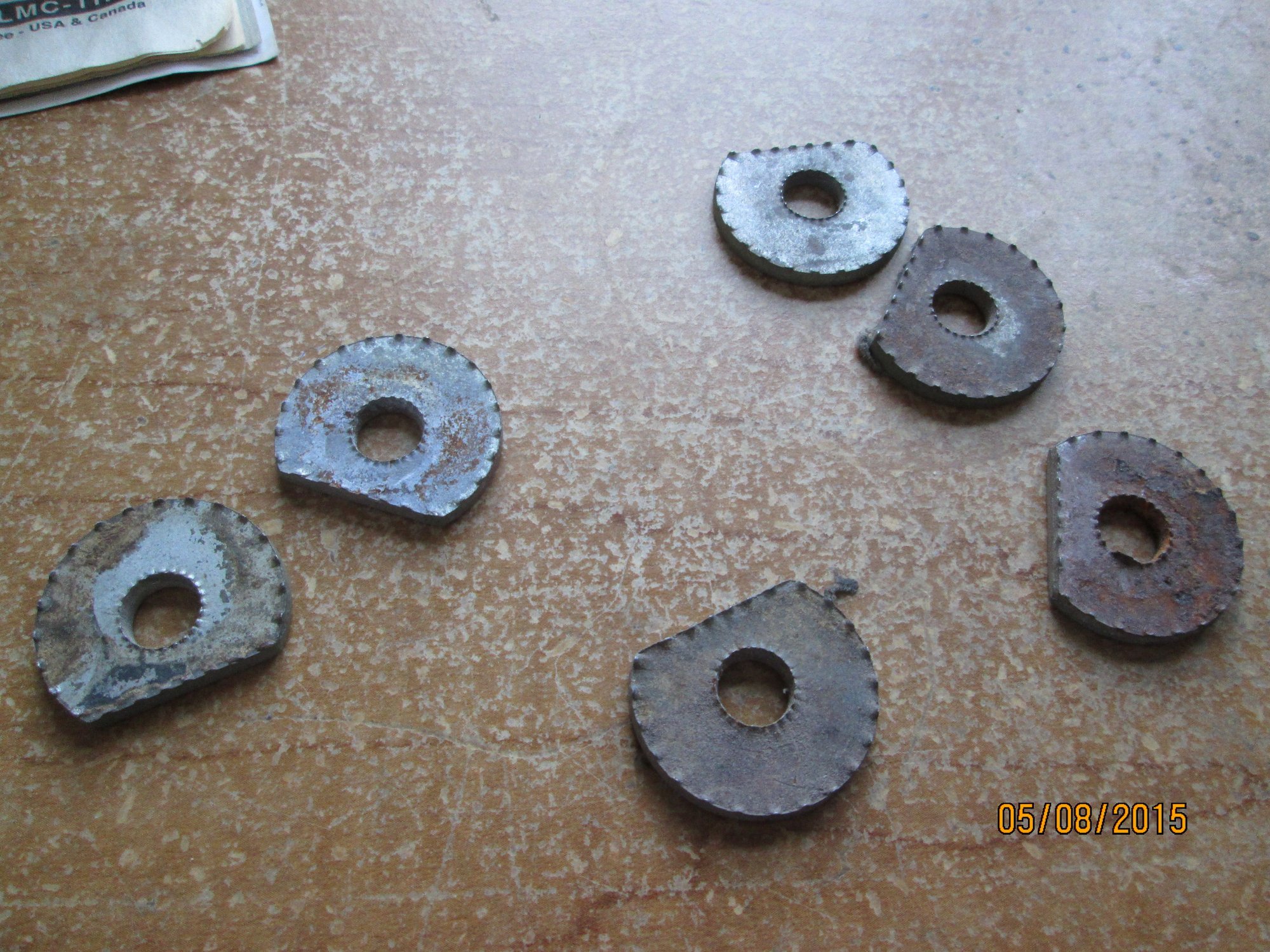

What are these
Does anyone know what these might be. They are 5/16, like a star washer on one side. I think they might possible be shims for the front fenders, but the label fell off the bag. There are a total of 6. Thanks gang

They are washers used on the hood hinges.

Those washers are used inside the vehicle cowl sides where the hinge plate mounts. They grip the sheet metal and allow for some adjustment of the hinge plate against the cowl. They are difficult to locate in a parts book as there is not much demand for them and they do not wear out.

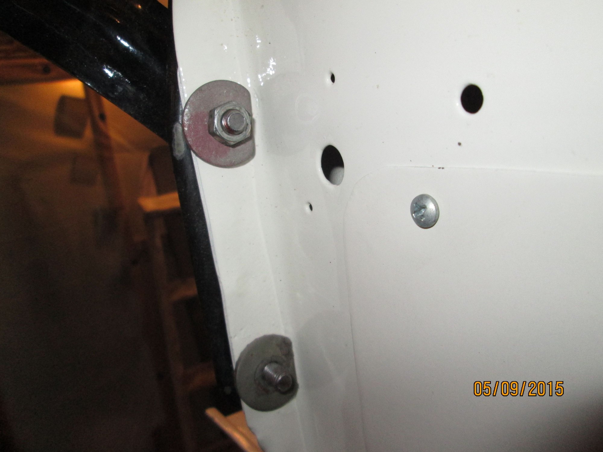

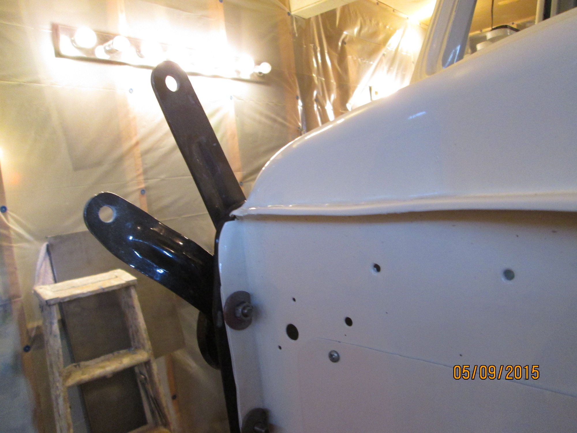

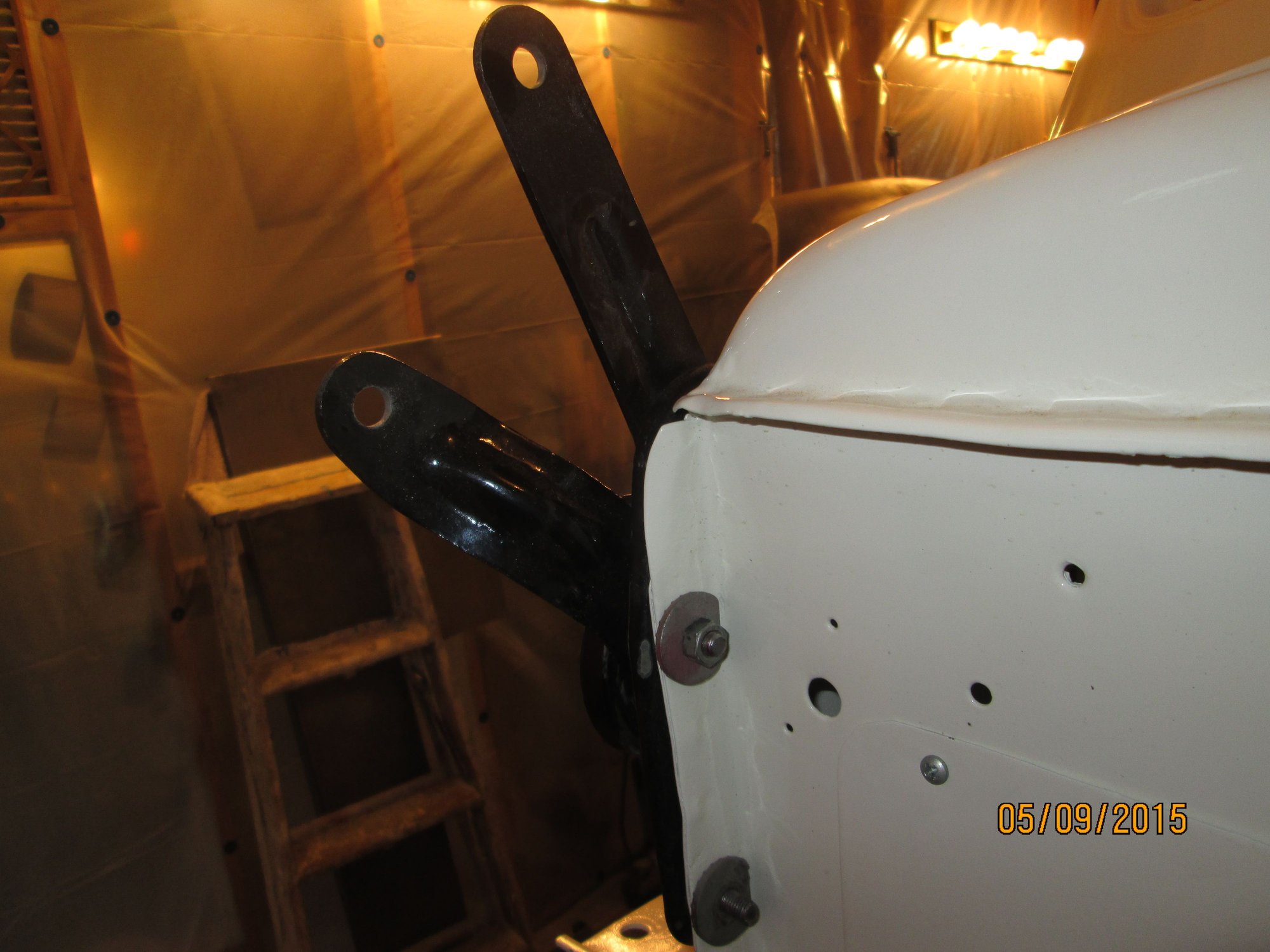

Do they go something like this. I only have 6. should I have 8..I found a part number for them in the parts book 351362-S2CXX118, but they do not list the quantity per vehicle.
