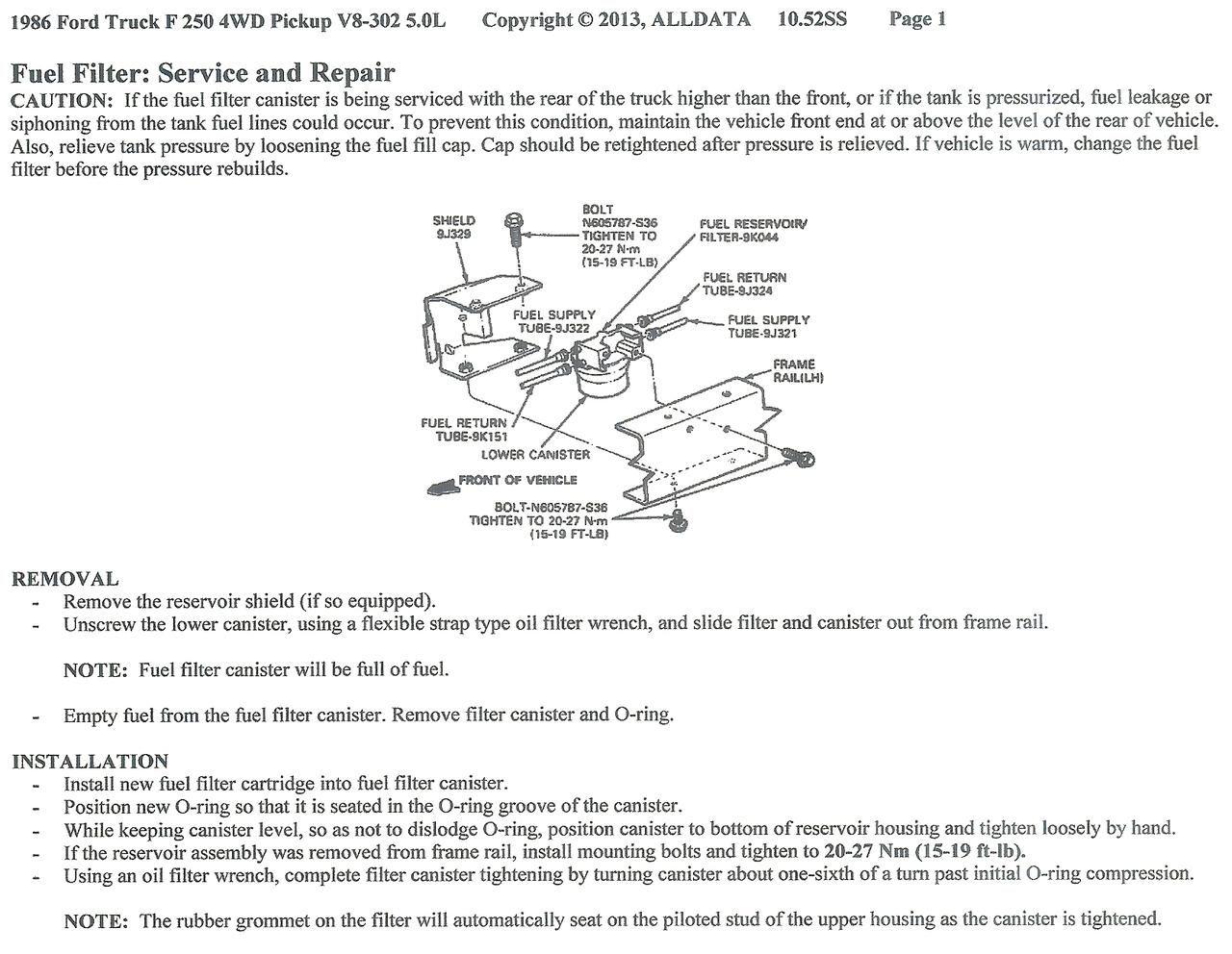

Here's the regular fuel filter.
Here's the other one that may be located in the switching valve or on the frame in it's own housing.
Yeah, I already forgot about that! Another guy over the past several weeks had similar problems, most of which turned out to be that filter which I think is located on top of the gas tank(s) or someplace thereabout. Apparently, this is in 1985.5 - 1986 models only, read here for more info:
https://www.ford-trucks.com/forums/1...4-5-0-efi.html

Courtesy of 85lebaront2
I hate to be repetitive, but can you absolutely confirm you do not have this filter anywhere on your truck?? Reason being is 15 pages on a single thread, multiple codes and numerous hours were spent trying to work through a problem exactly like you describe, all due to a single filter
