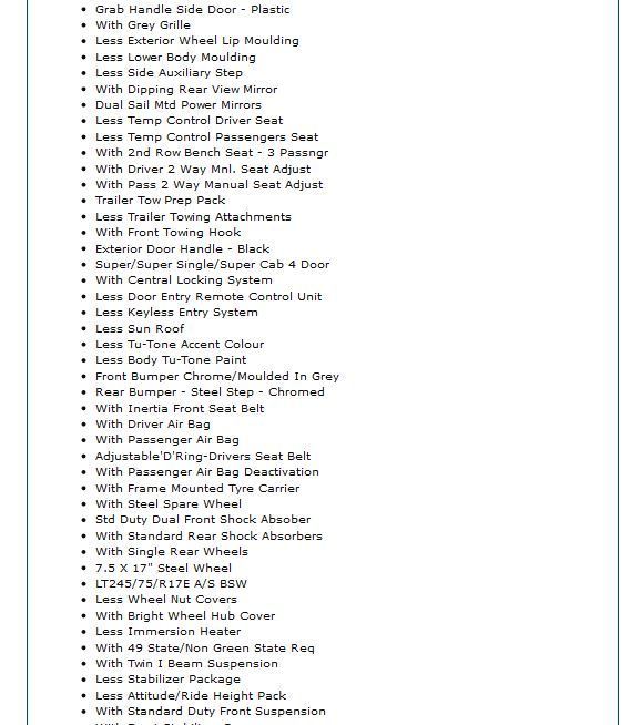

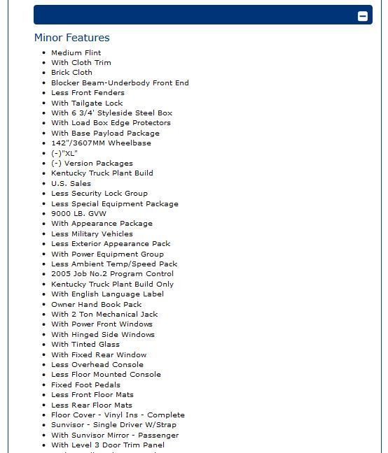

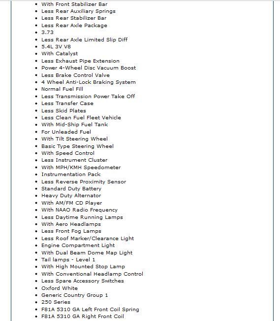

ok I can't figure out why my VIN number doesn't follow the above legend. My vin off the door sticker is: 1FTNX20555EC46061. I can follow along until X20 then it goes wonky.
Ford ETIS report

Thanks @Just Stroken appreciate the help. Ton of info there - i have 265K miles on it and bought it six years ago for 3K. Solid truck just needs a new bed. Thanks again.
