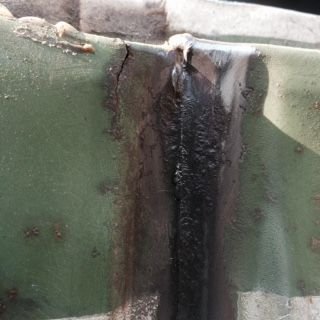

Thanks for the replies. I am attaching some pictures of what I see on my "bad" doner cab. I am practicing on this to see what I need to do on the "good" doner cab so I don't make a mistake. It appears that the panel is lapped. Outside it is welded and inside it has seem sealer on it. But I am looking for help.
This is a picture taken from the inside looking out. This is driver side
This is a picture taken from the inside looking out. This is pass side
Here is a close up of the seam inside. It appears to be not welded or seam sealed.

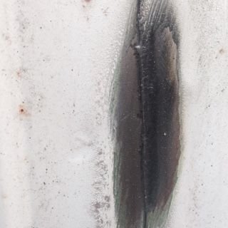

These next two pictures are taken from outside. I have scratched the seam and it seems hard. I may need to get a wire wheel on it to see if it is sealer or weld.
These next two pictures show what the "good" doner panel looks like after I took a wire wheel to it.
