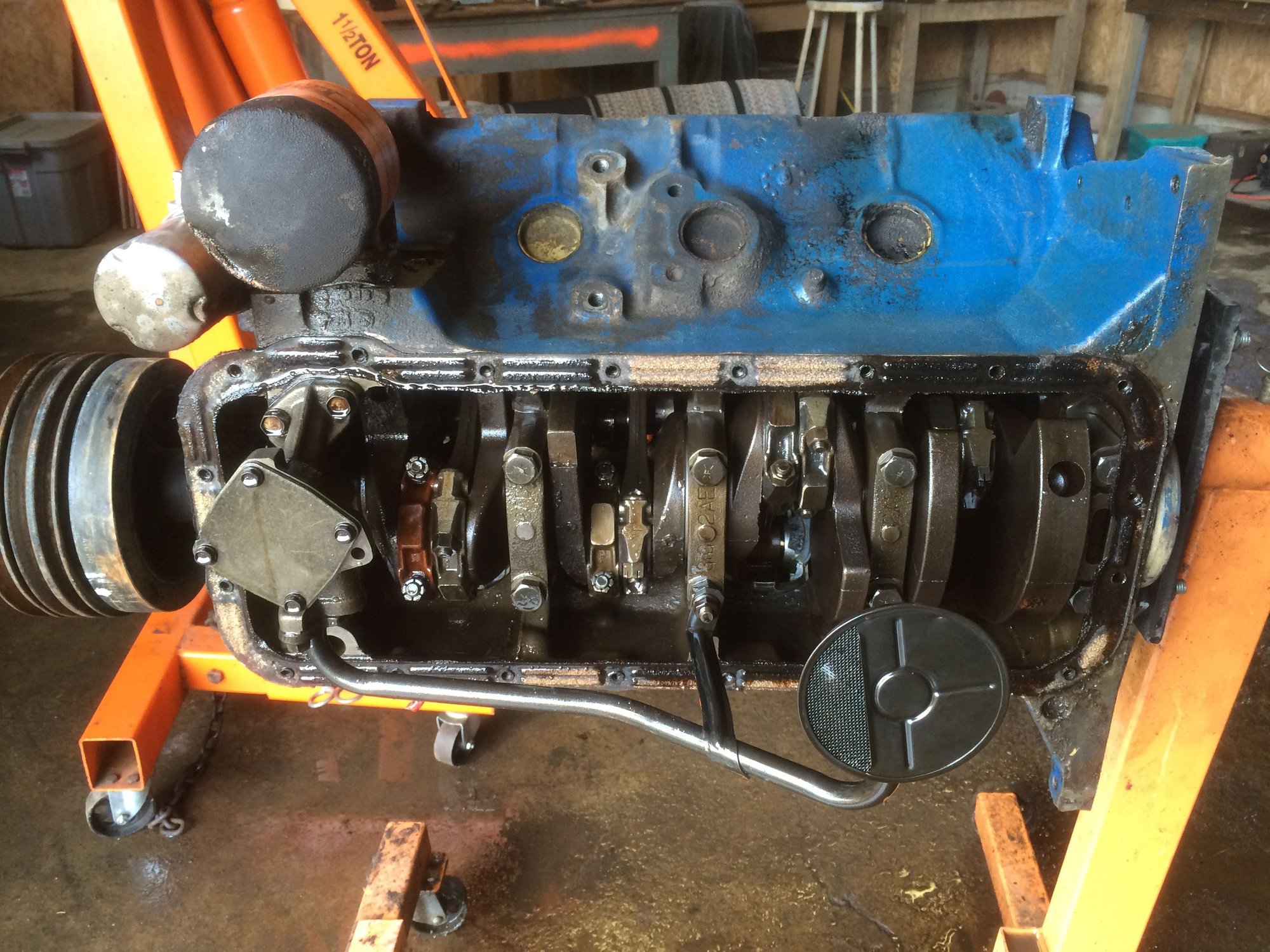

I am in the process of building up a 390 for my truck and I found this...
Has anyone seen something like this before?
I read that in the 70's they might have done this as a repair procedure.
It's worth noting that this rod is for the #1 cylinder in my 360, which only had 60psi compression.

If you are turning it into a 390, the rods go into the scrap pile anyway.
This came up once before, can't recall if there was a plausible answer.

Interesting - someone once told me it happened because when the engine rebuilder put the rods in the acid dip with the bearing shells still in the rods, the copper got plated to the rods. But the "resizing" explanation sounds a lot more plausible

That acid dip might result in transfer as well. Maybe someone can have their kid do an 8th grade science project on this.

It was a resizing technique is also what I was told. The last motor I rebuilt had one in it. I still had to resize it but no problem.
