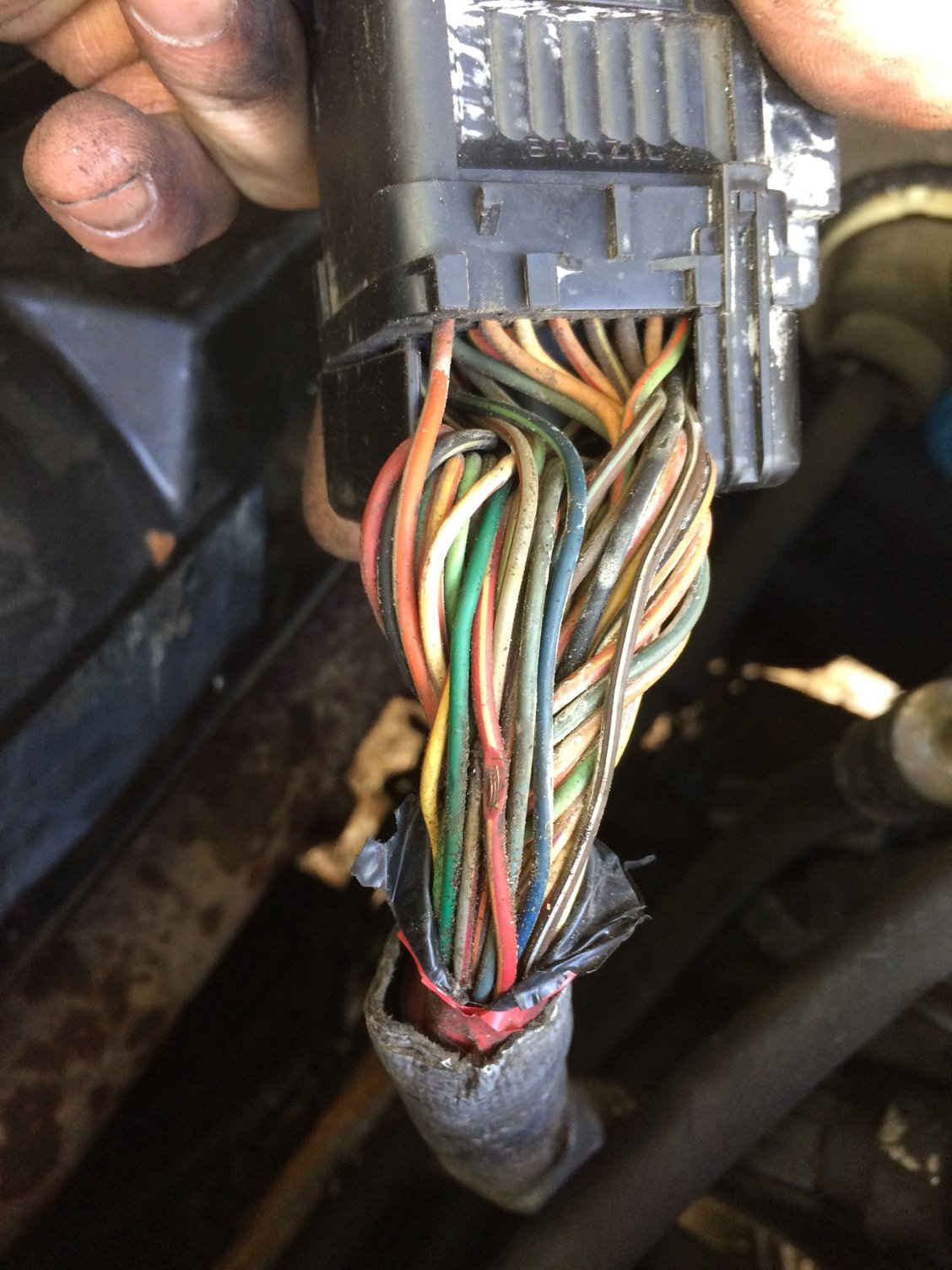

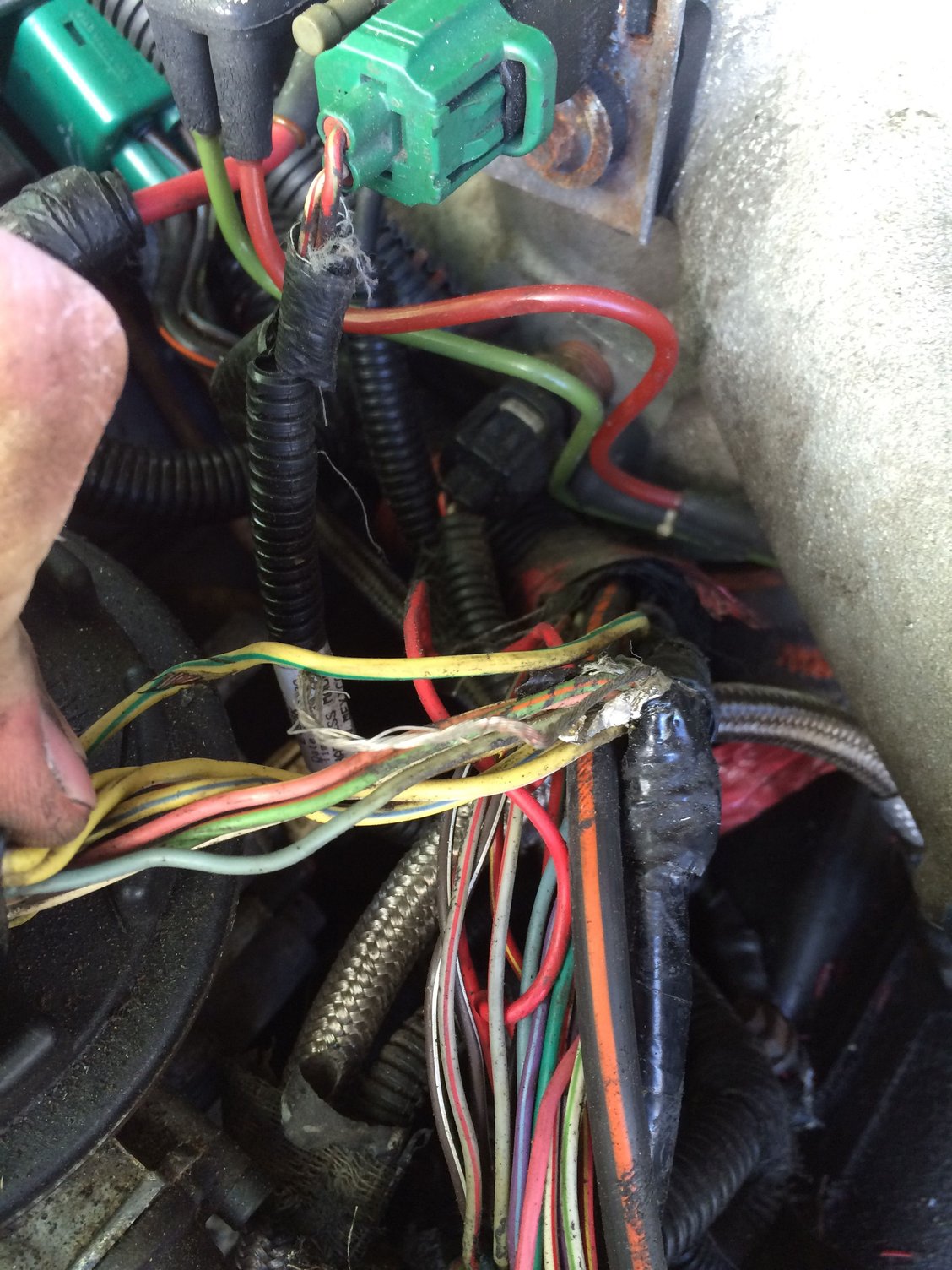

Starts fine with DS valve cover off but not when installed? Check for chafed wiring where the harness from the 42 pin connector crosses the valve cover. Just a thought.

I'm starting to wonder about the harness now. This morning o figure I would get it not to start it was 40 degrees out. But nope started right up missed for 5 seconds then was smooth.

If those wires short to ground (against a valve cover, bracket, or any other metal object) they can cause a no start or stall situation. Tape up all the chaffed wires and look for more before you try again. Be sure to check the wires coming out the bottom of the 42 pin connector that rest on the valve cover, as well as the wires coming out of the back of the connector and go over the valve cover.

The wire that rubbed through was on the valve cover. Does anyone know what it's for? To cause that many issues. I will try to start it tomarrow morning to see if it still cold starts. I'm not sure what the other bare wire is for but I wrapped up everything tight with rubber tape.
