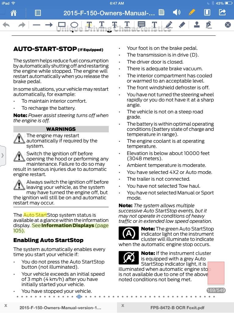

For reference, here's what the manual says about auto-start:
