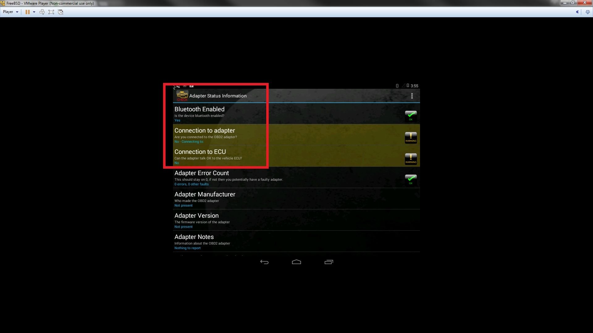

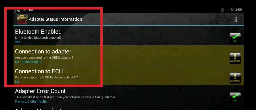

I am getting closer!
I will do some more testing with this setup tonight. I got bored at lunch this is on Win7 laptop I don't have my Win8.1 tablet with me so I will have to test that next week.
