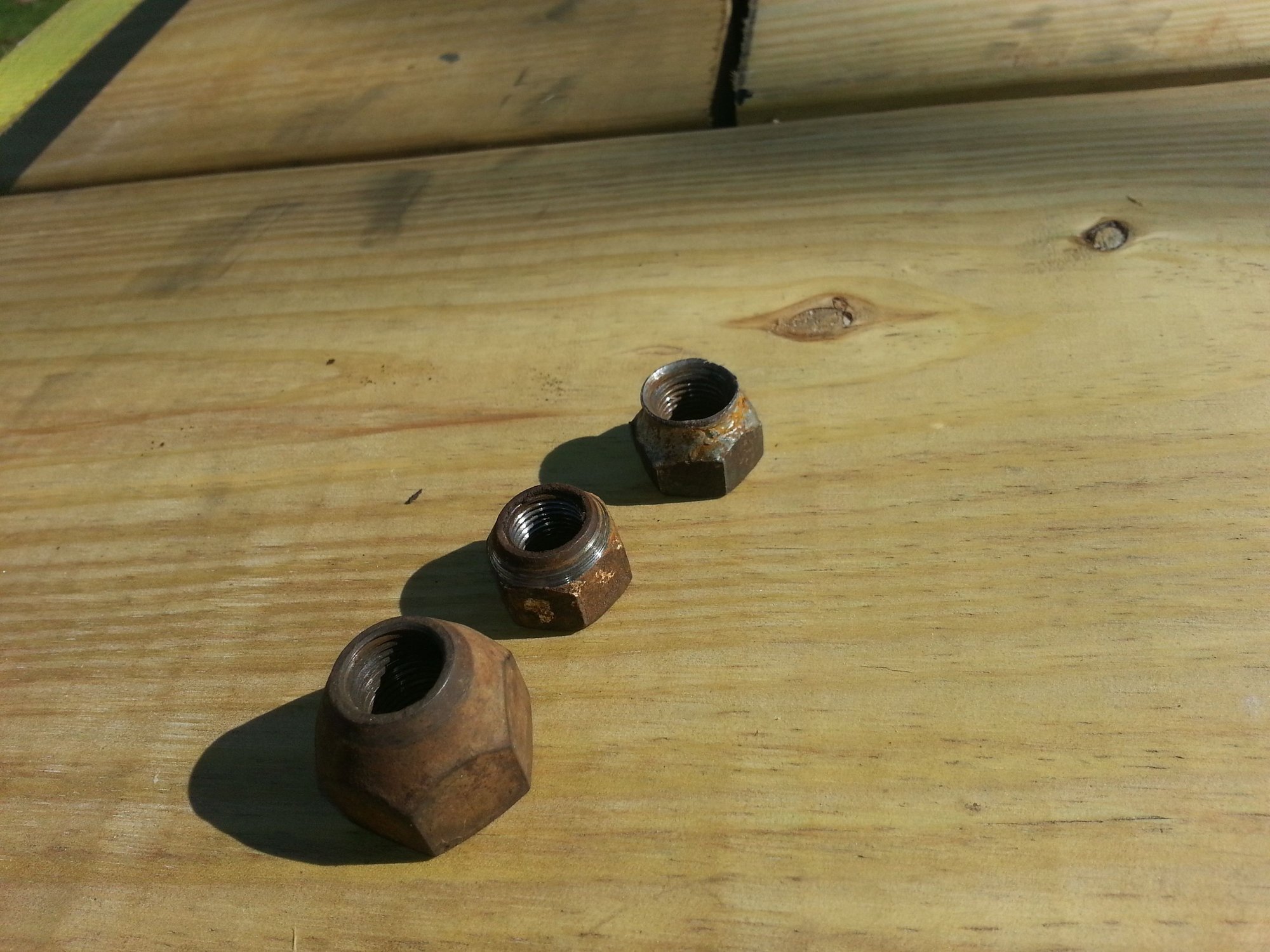

So i have a 79 3/4 ton truck and the front left wheel loosen up on me while driving and i know i tightened it i double check all that kind of stuff but a guy told me i have the wrong lug nuts and i need ones with a bigger head on them like the one ton with a 1 1/16 hex? i have 1/2x20 with a 13/16 hex is this the right size for my truck? I was told this size bottoms out on the hub and it may seem toght but its really not

Ok i have the tapered end style im pretty sure. But i will get some pictures when i get home to show you what happened with the lig nuts
Old Apr 27, 2015 | 10:35 AM
tomwerm's Avatar
tomwerm
Joined: Jan 2015
Posts: 61
The smaller lug nut is the one i have and i am getting told i need the bigger one but obviously the same thread

What do the lug nut seats on the wheels look like? And how does the size compare? It looks like the holes in the wheels might be large enough that the small ones are barely catching - the big ones would help with that.

The seats on the rim seem to be fine but the lugs DO sit in decebtly deep (right to the bottom edge of the hex) but if i order those buldge acorn lug nuts i think that would fix my problem wouldnt it

Just so it does not catch you off guard. This style lug nut usually has a smaller hex, probably 3/4", as they are also used on wheels that have small lug nut holes and use a thin wall socket.

My 75 used what's shown in the middle pic, my 86 and 87 use the bigger ones but have a 9/16" thread.
Those "bulge acorn" style ones were used on CV, GM, and Town cars with "locking" wheel covers.
You should be able to use the middle ones ok (13/16 " wrench size?) Is the smaller -NG- one 3/4""?

The biggest problem is he is using a newer steel wheel that is designed for a 9/16" stud and nut and they usually have a larger conical seat area on the nut. While not a perfect fix, I think the bulge acorn lug nuts should work.

OT, sort of, notice the wear pattern on the 1 1/16" nut. I've had problems with the taper squeezing down on my trucks making it difficult to put on the lug bolts. Hard to run a tap through the nuts.

It is a 13/16 socket for the ones im running and i found these ones https://www.google.com/search?q=dorman+611016&client=ms-android-sprint-us&hl=en-US&source=android-browser-type&source=lnms&tbm=shop&sa=X&ei=HnE-VcHPL5CgoQSx44CoCA&ved=0CAcQ_AU#spd=47649181527440 73757
It has a 13/16 hex for the drive and it has a bigger flare so im thinking these would hold better then the buldge ones possibly??
