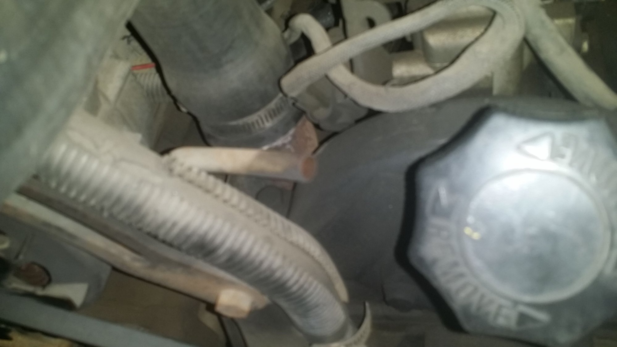

Little metal tube next to oil?
Do you guys know what this is and why it doesn't have a dip stick?

That missing bolt looks like it goes to the sway bar link.
Before trying to figure out exactly what is leaking, I'll again recommend cleaning everything up the best you can. Try to get all the oil and dirt off. Oil tends to creep around, so a leak one place may cover something else entirely. Get it all clean, and you can trace back to the start much easier.

the cable out of the side of the back of the trans is the speedometer cable.
