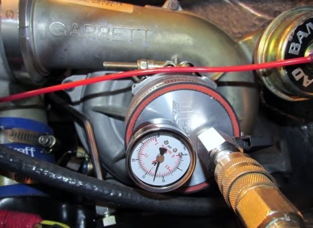

Maybe I'm confused but when I hook the Dieselsite Tester up and follow the instructions given by Dieselsite I do get some airflow out the 90 degree hose on the doghouse. Intructions are clear to pressurize intake to 10-15 psi on the tester air gage, shut-off airflow using the ball valve on tester and check for leaks. It does say that the pressure will bleed down through the valves in 30 - 45 seconds. I start to get airflow out the CCV tube at as low as 7 psi? The air coming out smells like crankcase oil . Is air coming out the CCV hookup hose normal. Here's two pictures of my hookup.
Old Apr 27, 2015 | 07:15 PM
The Brad's Avatar
The Brad
Joined: Nov 2013
Posts: 868
From: SoCal
Some air is normal, too much isn't. For reference, iirc, I think mine took between 10-15 seconds to bleed off 20psi once I shut the ball valve.
Any pressure differential from either side of the piston rings will bleed past them whether is 1psi, or 1000psi.
