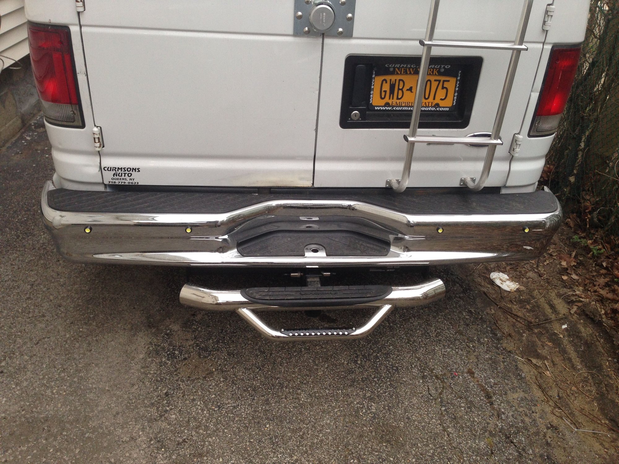

I just bought one last month from this ebayer,
http://www.ebay.com/itm/261160417506?_trksid=p2057872.m2749.l2649&ssPageName=STRK%3AMEBIDX%3AIT
I have no affiliation with the ebay seller just so you know. At $331, It was the best price that i could find. It comes with both step pads. Its not OEM but looks exactly the same (to me anyway). So far its holding up well and looks great! Made in Taiwan . I had just a regular bumper before, what a pita getting in and out!! I checked Craigslist for about a month but everything was either rusted, scratched heavily or dented up. I bit the bullet and even took it a step further literally and got a Curt hitch and put a double 'go rhino step' in the receiver. Easy to get in and out plus looks awesome!!

That looks great. Nice van too. What is that metal piece between the doors, a security lock? Also how easy to install bumper?
Thank you, that's a puck hasp lock. The bumper is pretty straight forward. 4 bolts hold it on, that's all. The top nuts spin off fairly easily (at least the did for me). The bottom 2, not so easy as the plastic backing on the bolt will commonly break and the whole thing just spins. Use an impact gun and you'll have no problems. I heated mine up first and the impact took them right off. I set up 2 5gallon buckets underneath for the install of the new bumper. Pretty easy overall.
Oh, not sure if this is necessary but i disconnected the battery as a precaution when i changed the front and rear bumpers (airbag). Im sure others will chime in on weather or not its necessary but for me, when in doubt disconnect the battery ..
