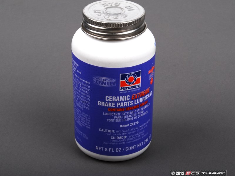

What kind of lubrication are you using for the calipers and pads? I just recently started using the stuff below. Napa seems to be the only one local to me with it available. I do also use the disc brake quiet on the backs of pads. Started with a goopy kind and now have a aerosol version.
Amazon.com: Permatex 24125 Ceramic Extreme Brake Parts Lubricant, 8 oz.: Automotive Amazon.com: Permatex 24125 Ceramic Extreme Brake Parts Lubricant, 8 oz.: Automotive
