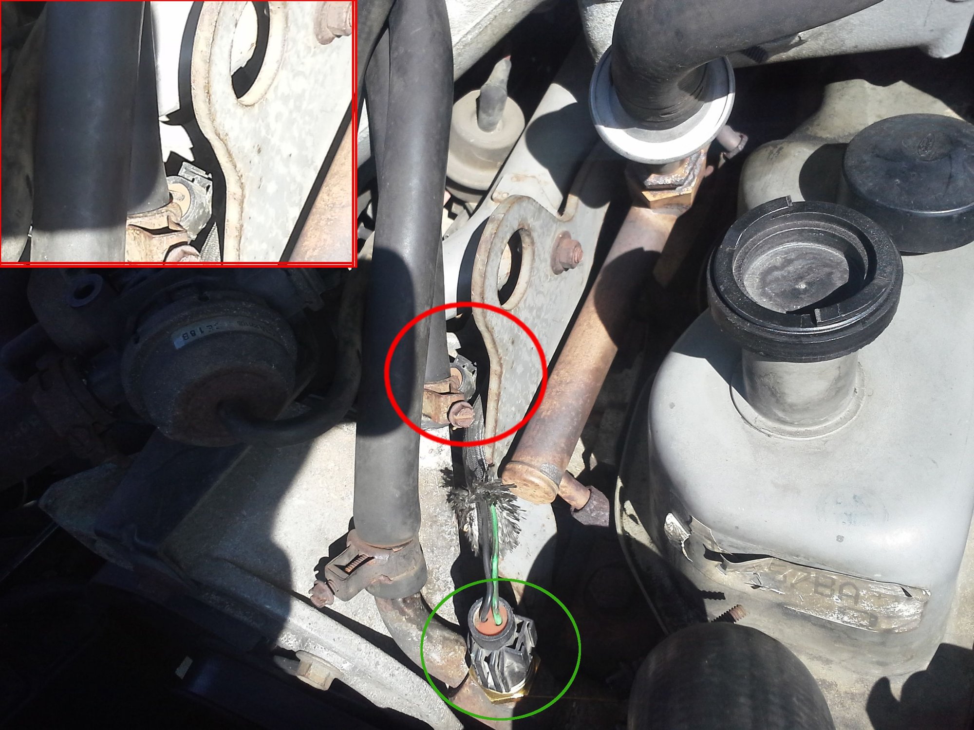

This isn't a coolant temp sensor is it? looks identical.
Old Apr 4, 2015 | 02:45 PM
anthonym92's Avatar
anthonym92
Joined: Feb 2015
Posts: 510
yes thats the coolant temp sensor

Question
To confirm, you are talking about the one circled in red?
Old Apr 4, 2015 | 07:50 PM
anthonym92's Avatar
anthonym92
Joined: Feb 2015
Posts: 510
haha i thought he was talkin about the one in green
Old Apr 4, 2015 | 08:55 PM
Grems4ever's Avatar
Grems4ever
Joined: Aug 2009
Posts: 7,565
Likes: 249
From: Laquey, MO
The top circle is the charge air temp sensor in the #1 intake runner. The lower intake on the 4.9L is dry and doesn't have a coolant temp sensor.
Old Apr 4, 2015 | 11:55 PM
BLACKHAWK_1989's Avatar
BLACKHAWK_1989
Joined: Feb 2014
Posts: 113
From: Washougal
Question What tha deuce?
Hmm... Could it be reading an error in my gauge sensor? I only seen it go up almost half way even when the engine gave off more heat then usual. The one in green is a new sensor and fixed error 21. Which coolant sensor is error 51? This is an 88 F150 with an Inline 6 motor and 3 speed granny. "4 gears + R"
