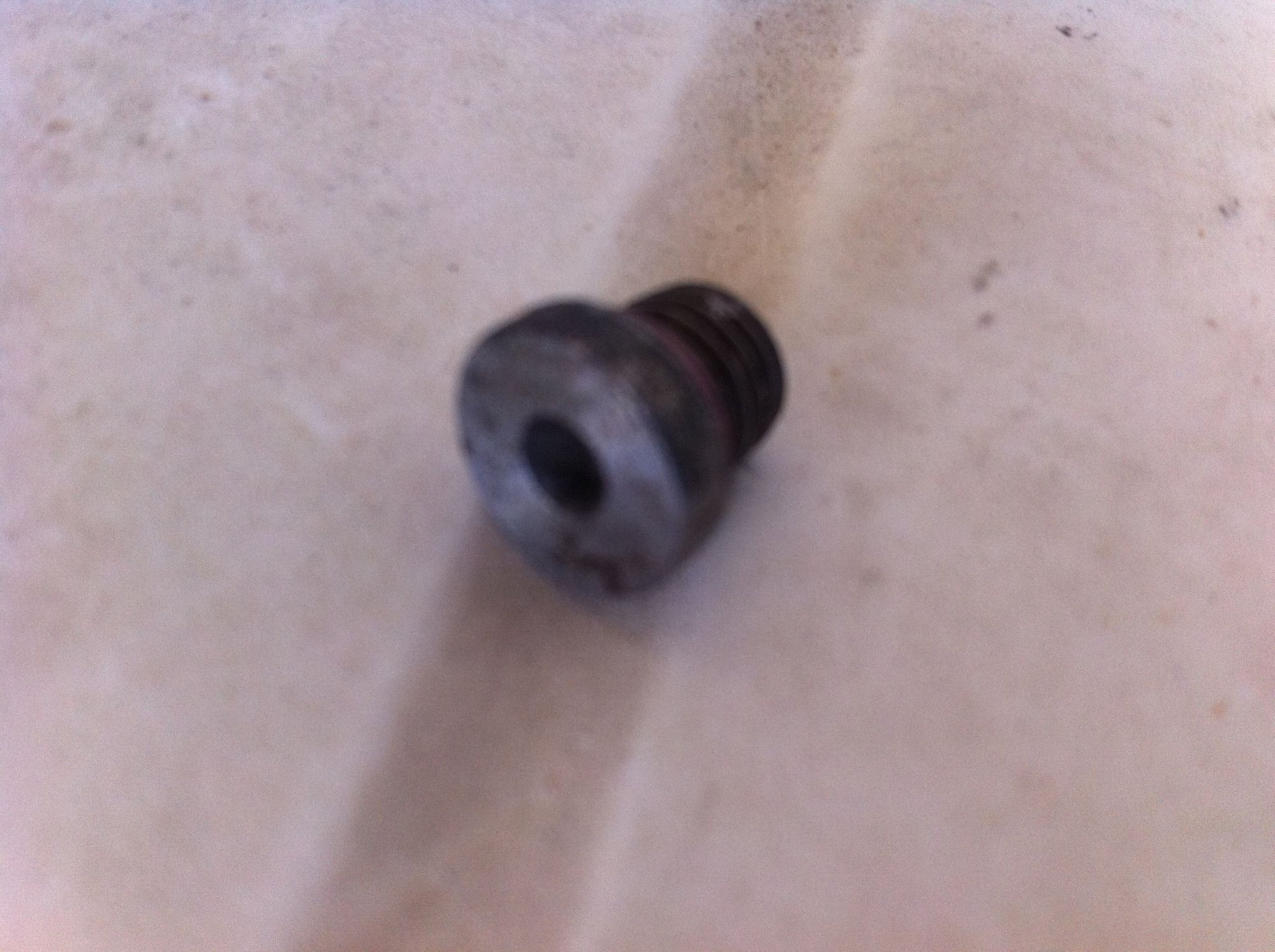

So I went back again when the sun was setting so there wouldn't be so much ambient light, and I could see a little better. As is said before there is a lot of sludge up around the HPOP, but I really couldn't see any fresh oil, but back further in the valley, I could see some fresh oil, starting just under the intake assembly for the turbo. Going back further it still wet looking under the turbo, but the turbo itself looked dry. Maybe I just didn't get that area as clean as I could have using engine cleaner and a hose???
But up front again, just under the HPOP, I did find a little plug, 3/8" standard thread, "O" ring (you can just barely see it on the picture at the top of the threads) and 1/8" hex fitting on top. For a second I thought I had an "aha" moment, until I realized that if that a 3/8" plug was missing anywhere in the oil system, lpop or HPOP, it would be a flood, not a tablespoon or so under the truck after driving for a while.
Still, do you all have any ideas where that plug might go? I am assuming someone was working on the truck, dropped the plug and rather than looking for it, got another.
