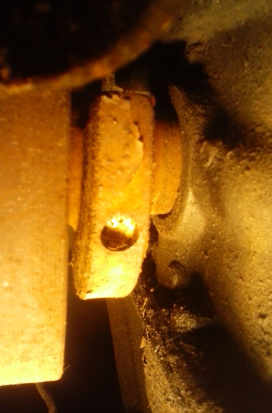

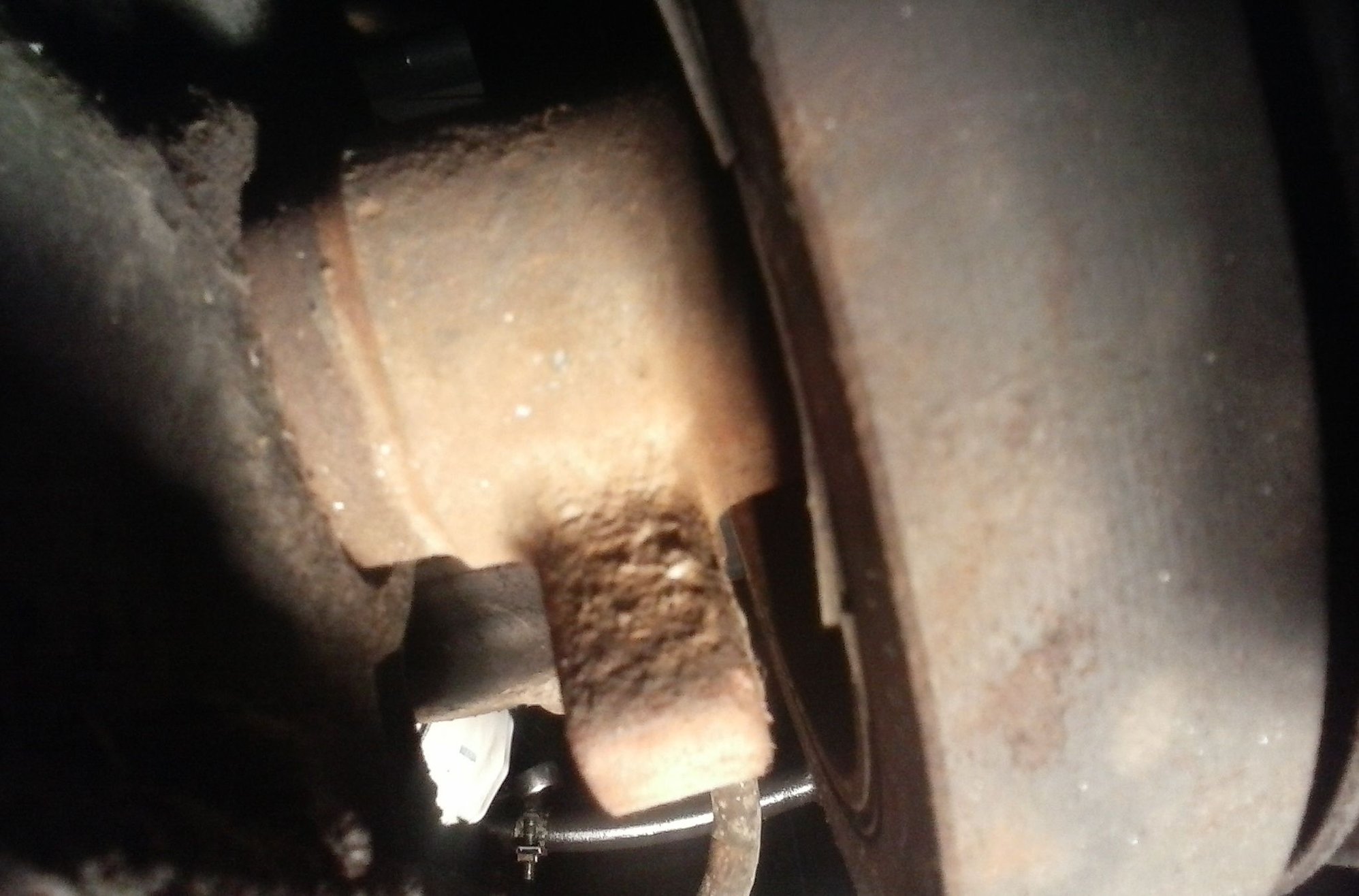

Pics of the hatchet

Ford went to the parts bin to make the 428 SCJ. "Le Mans" rods are as in the 24 Hours of Le Mans race in France, which Ford spent billion$ winning with the 427.
Motor history:
https://www.428cobrajet.org/428cj-history-bill-barr
Le Mans rods:
https://www.428cobrajet.org/id-connecting-rods
Congrats on your score. As per prior post, you may find someone willing to pay a pretty substantial premium for this motor.

Nice Score!
The Vin is from a "R" code 1969 Mustang. "R" meaning 428 CJ/SCJ ram air
The lemans rods will have bolts vs studs and nuts.
The 428SCJ lemans rod will have a shorter head on bolt
The crankshaft will have 1UA on it
Does it have a carb and distributor? Exhaust manifolds?
If its an original SCJ all the ones I have seen have SUPER stamped on front of block above pan on drivers side.
If you check the registry that engine could be worth a bunch of $$ to original car if it can be found. Especially if its complete with exhaust, carb, distributor.
Does it have a windage tray? between oil pan and block?
What does it have for oil filter adapter?
I may have missed it but did it come with a flywheel? Stick or auto?
Looks like it has the wider SCJ balancer also
