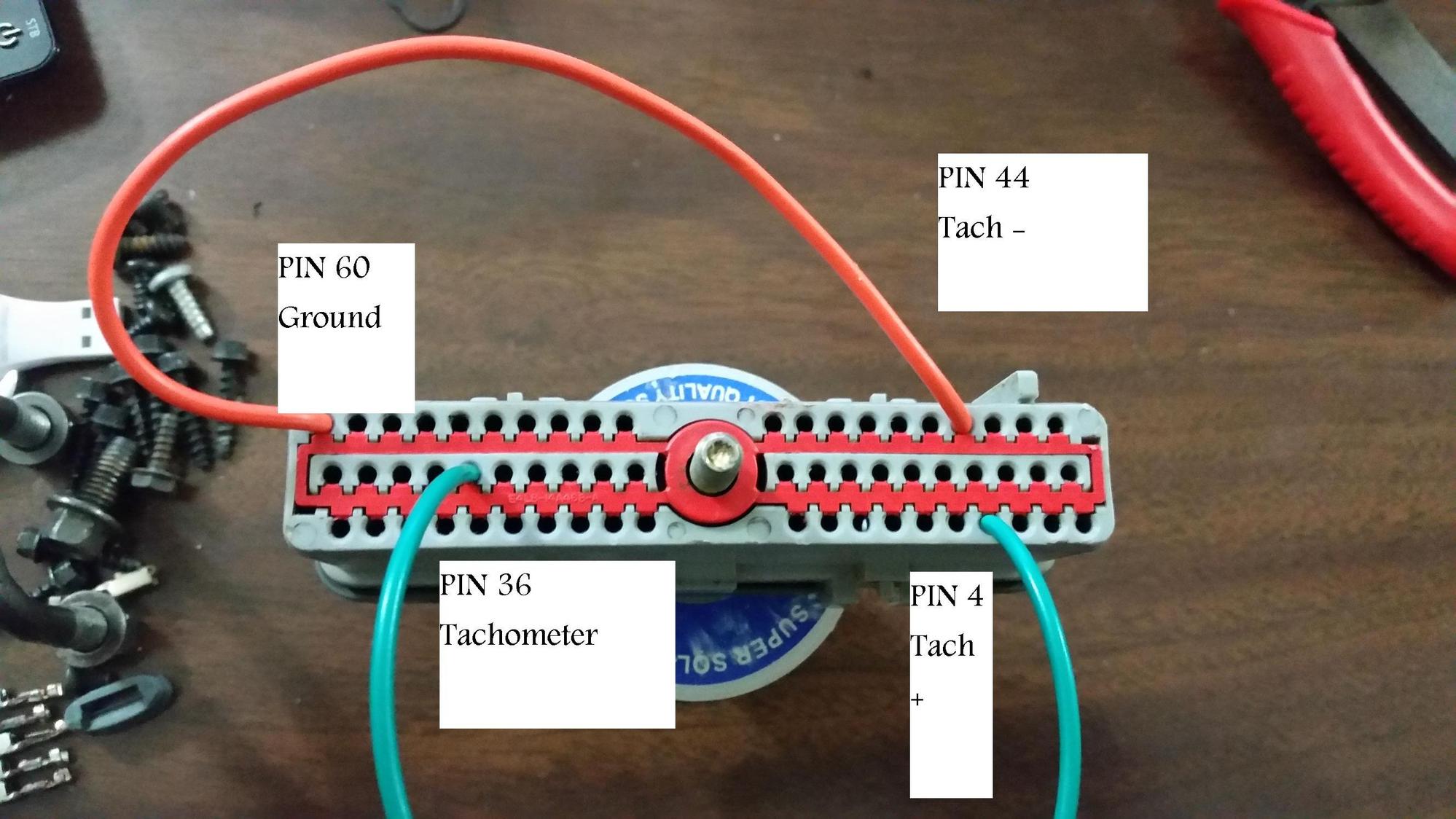

If your sure you have no bad wires and all connections are clean, I would suspect the TECA (computer). The TECA takes the tach sensor and buffers it and sends it to the tachometer, so what I would do is unplug the TECA and jumper 2 sets of pins and start your truck up and see if the tachometer works that way. you will need 2 piece of wire nothing too long and follow the picture. This will NOT harm your tansmission as your not driving it, IF you do drive it the trans will be in limp mode, exactly what the TECA would do just so you know.

Ok, I jumpered just as you showed in the pic and my tach started working...so that means my computer is bad? Anyidea where I may find a new one?

That verifies your tach sensor and tachometer work, I would check a few more things like is the TECA for sure getting power? does it have good grounds? stuff like that before getting a new one. Junkyards, ebay, rockauto all have them, if you get a new one try and get a 93-94 one as those ones had updated programing in them, they are plug and play compatible with your 91 (do NOT get one for a power stroke it will not work, 94 is the mix year here)
