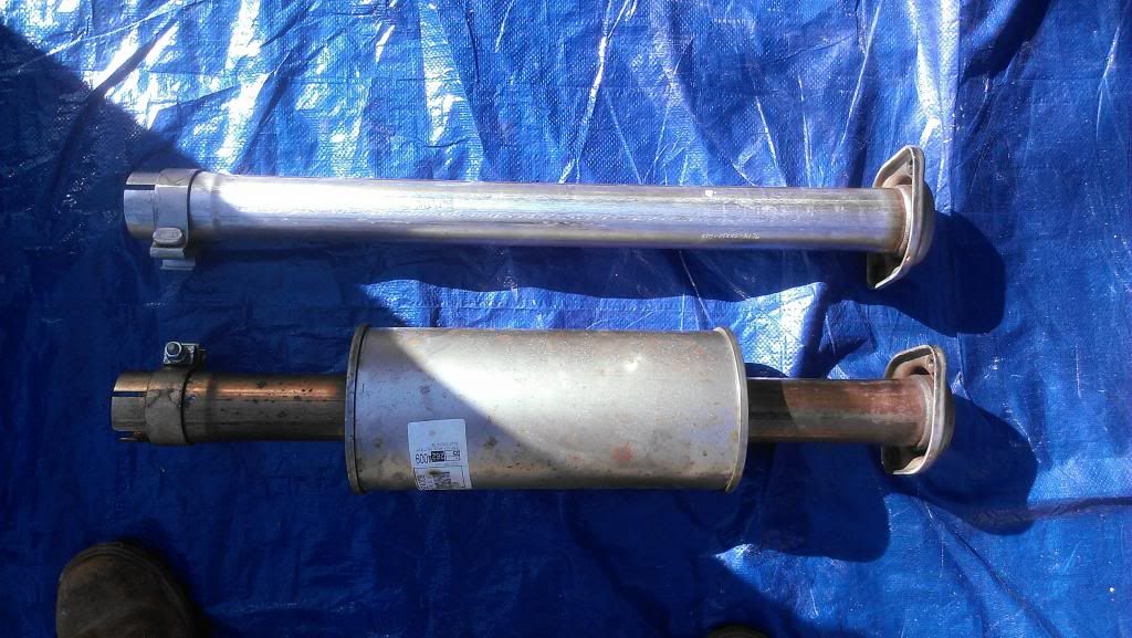

I did a resonator delete with a FMC pipe for $75 bucks first... should have just done the Borla from the start! Love the sound of the S-type
