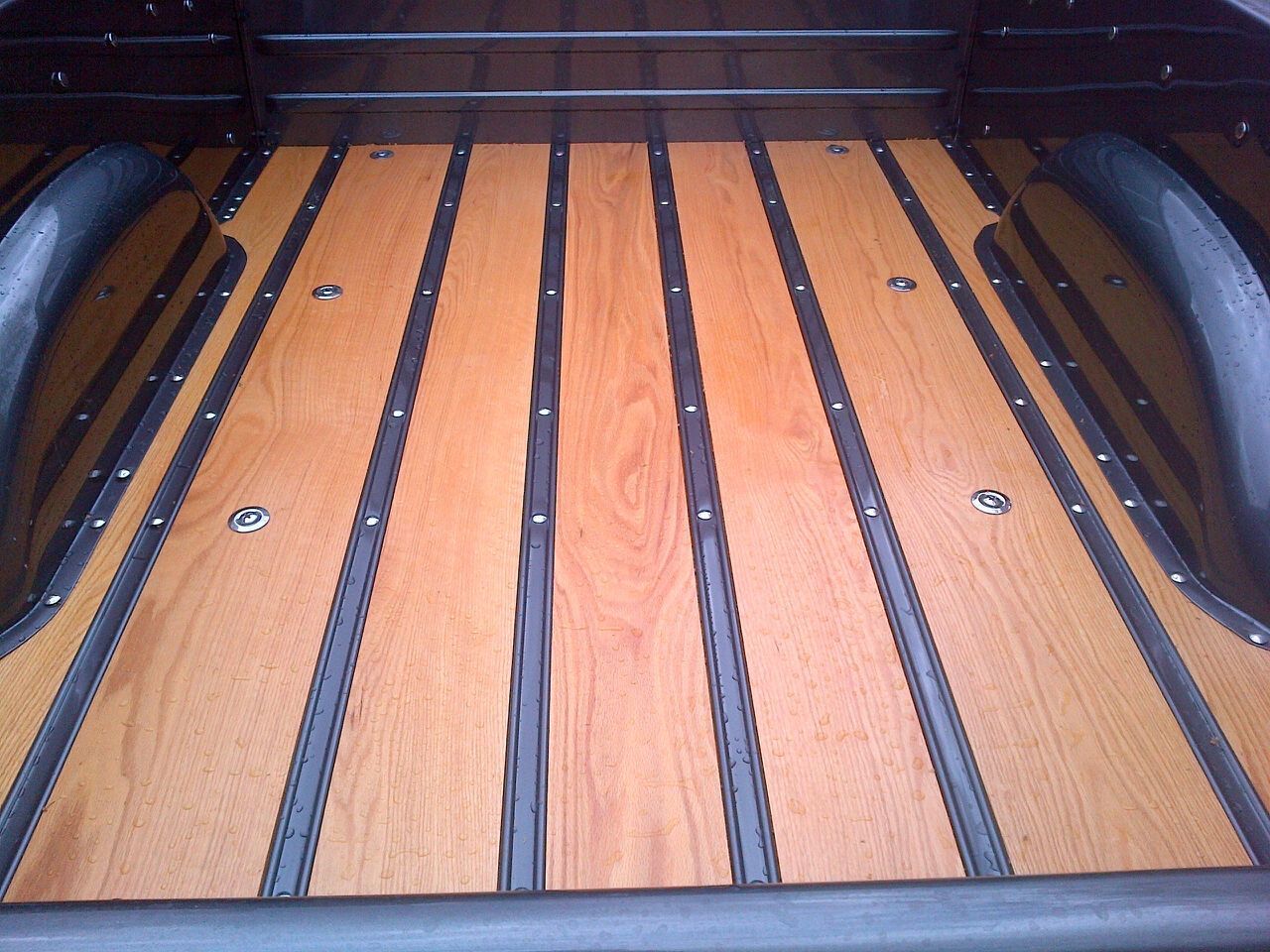

It wasn't complicated. I removes smaller peaces first: steps, flares, lights, bumper, tailgate, filler part. Then there're 8 bolts and that's it.

Originally Posted by nikmish
I've got my precut oak kit here: MAR-K Catalog - Select Your Truck
They also sell lots of other related staff.
Gee Willikers this is beautiful

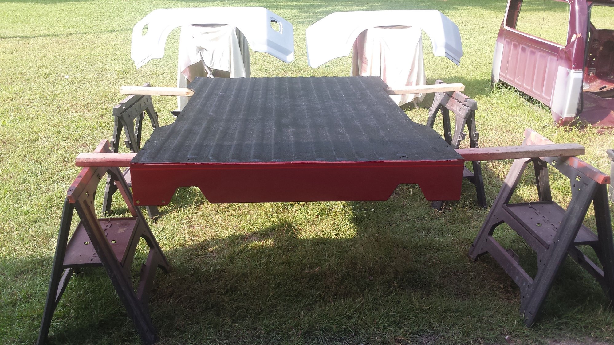

As for the wood floor on the flare sides 80 to think it was 83? used planks and think 6 metal strips.
84 to 86 used 3 parts of plywood and 5? metal strips.
All of them painted the trucks body color.
Me I did not have the money to buy all the cross beams ($1000) then the wood (planks or ply), metal strips and all the hardware.
So I took the parts truck LB style side bed and cut the sides off, 1 side was crushed in the roll over.
Made it shorter and used the metal ribbed floor to replace the wood and I can use the bed and not worry of hurting it.
Yes it has working dual tanks using all factory parts from my parts truck.
Dave ----
