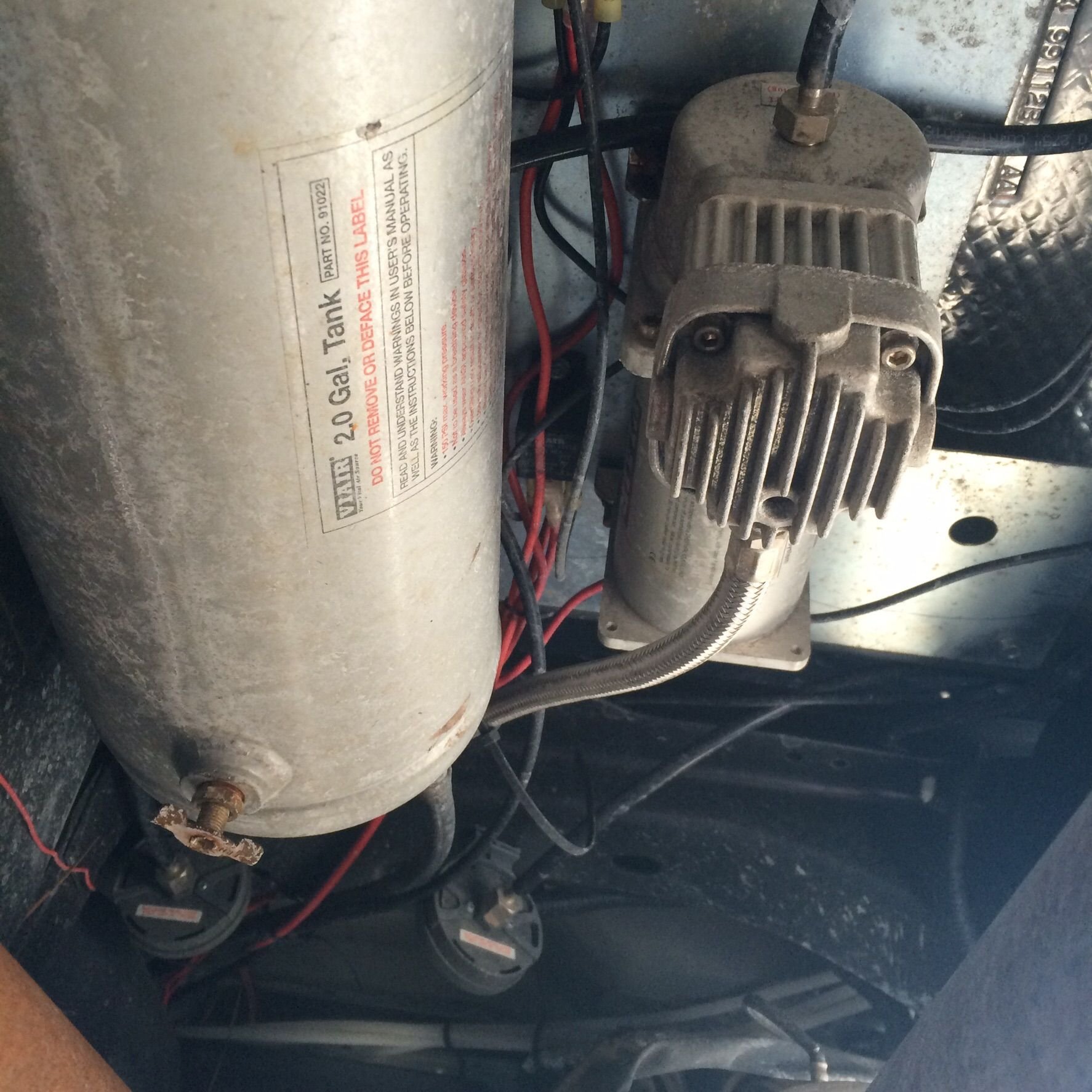

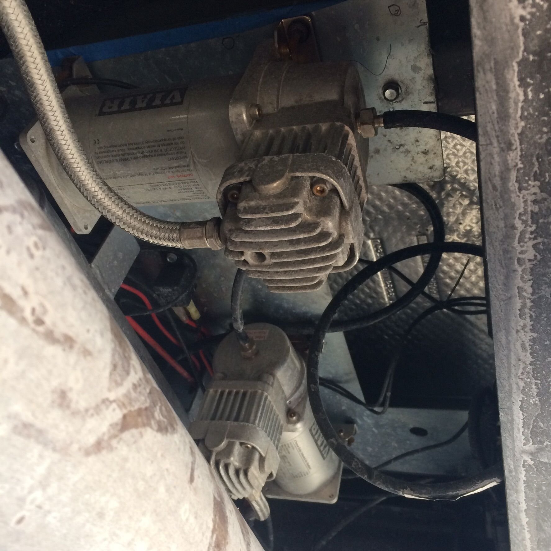

I'm a Firestone air bag guy through and through. I won't ever be without them, ever. I'm also a VIAIR air system guy, won't ever have a truck without it.
My loads change and I use 6 different trailers. Sometimes I don't use any air, sometimes I pump them up to 70psi just to keep my ride level. I hate being nose high.
Squirrelly, weird seat position, odd feeling of tilting your head and leaning forward, goofy headlights, it's a pain to be low in the rear.
Air bags will just make your truck level. It's only going to effect your ride if there is any air in them so when you're solo it's like they're not there.
You should be able to keep your trailer level by adjusting your GN post, looks like only 2" maybe.

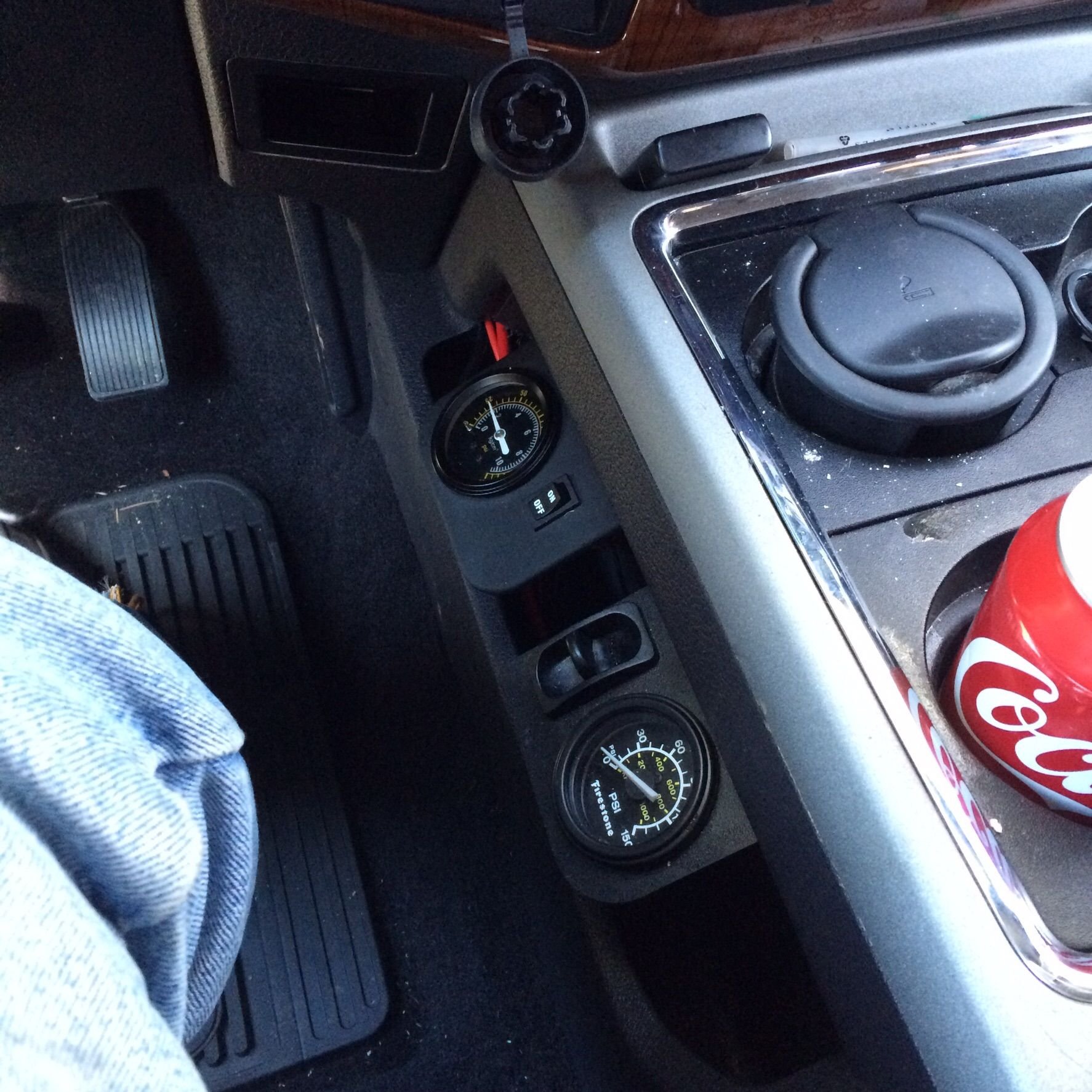

cab gauges and switches
Viair 10009 system mounted above drive shaft behind carrier bearing.

nice setup but your not suppose to mount the compressors upside down

I'd like to know where you got that info? I've been running them since 2007 like that.

Viairs website, I use there compressors also. It's under the frequently asked questions I check there site to verify before I commented. It also says that mounting them on there side isn't ideal but you can do it and I've had mine on its side from day one without issue. Not trying to sound like a know it all just passing the info along. Gotta lookout for my 6.7 brothers
Link to FAQ
Q: Is it possible to mount VIAIR compressors sideways, or must it be mounted with the cylinder upright?
You can mount in any direction or position since VIAIR compressors are oil-less. The only position we do not recommend is an upside-down mount, since heat tends to travel upward, and does not dissipate well in the motor housing. A sideways mounting may reduce the life of the piston seal, since everything is governed by gravity and has a weight associated with it.
