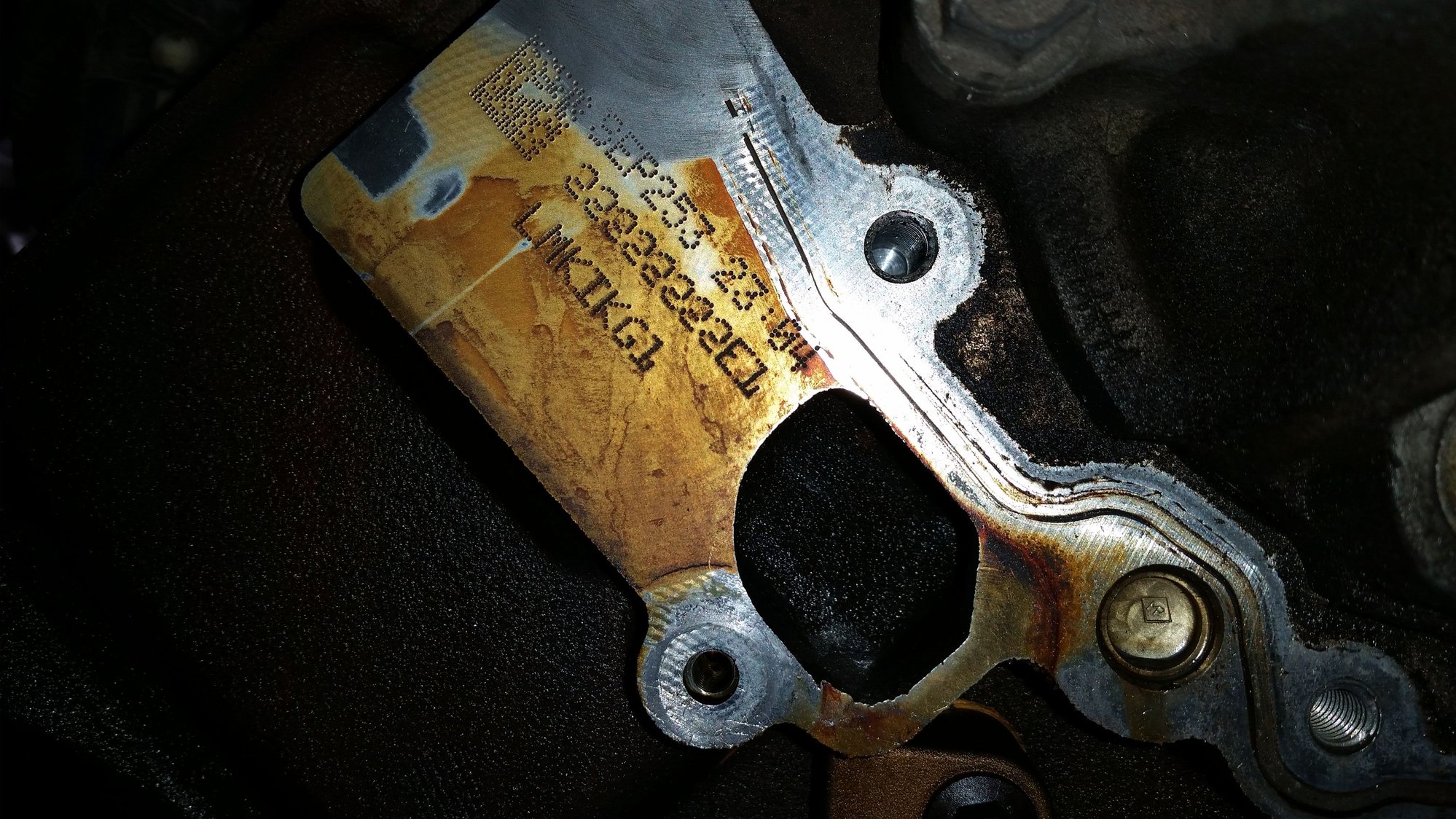

Checked out the oil passages, and guess what I found!
If you can't tell, these are pieces of the older chain guides. I could tell that someone had taken the front of the engine apart before, and now I know the reason. These were stuck in the big passage on the passenger side near the top of the block. This one:
But it looks clear with those pieces removed.
This may have contributed to the problem. I imagine that it would significantly reduce the flow from what it was designed to do.

Wow.
Here's an example of an issue that you could get all kinds of suggestions and feedback here, but until you pulled it apart, who would of known?
Great catch!

Great to see that you found something. Blocked oil passage to the heads was one of the suggested things, and I'm happy it was only that. Now you can bolt on new heads and feel confident that they'll last. I'd imagine the disappointment if you didn't catch this and had the heads fail again due to oil starvation...

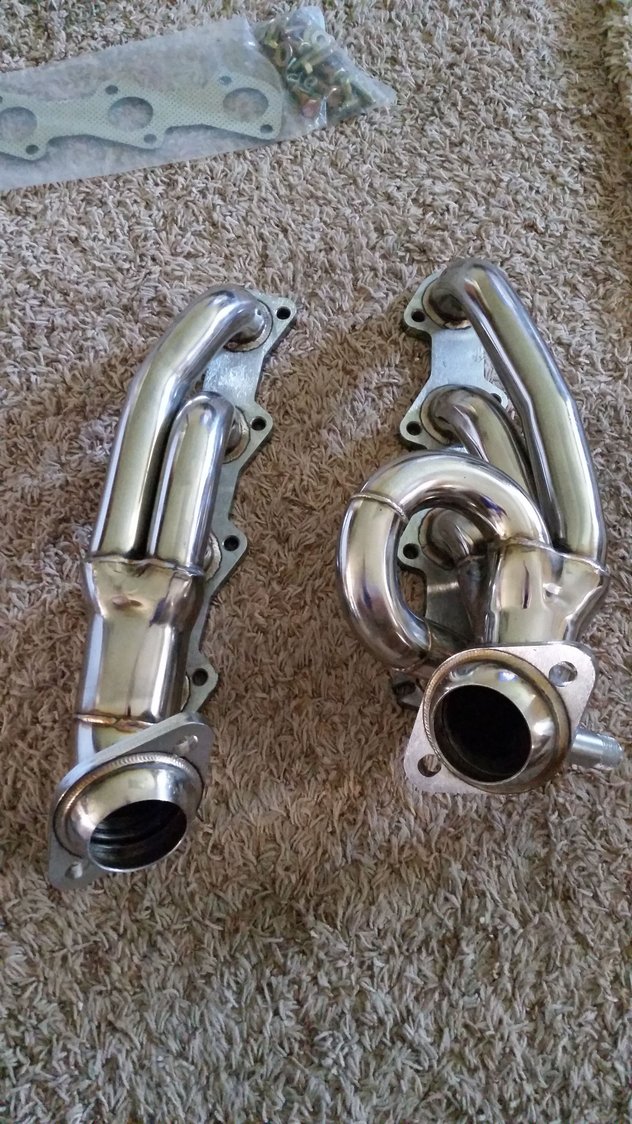

Yes! Exactly so, Skauber! And I wonder if the signs on the heads are showing correctly. I thought I was imagining things, but the passenger side head was just a little darker, the cam lobes tell the story. but more on that later. For now, the first of my new parts have arrived!
Aren't they pretty? I know it's a roll of the dice on performance, but I have never liked having a lump of iron instead of tubular steel for exhaust. if nothing else, they save a few pounds.

Nice pair!

Yeah, they won't do much on performance without diving deeper into the tuning world, but they sure look pretty! A stainless steel exhaust all the way is really the best, no doubt about that.
