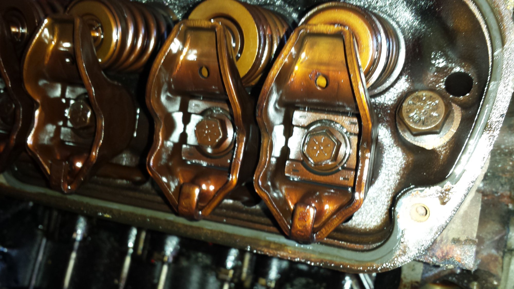

1996 351w lifters
1996 351w rockers
Took intakes off of both my 1994 351W and 1996 351W. The look the same to me? What am I looking for?

The figure eight pieces on top of your lifters are holding them in alignment. Normal lifters will rotate in the bore. Roller tips can't be allowed to rotate, hence the figure eights. The valley piece holds the figure eights in place. I know I'm not using the right terminology, but it's what my friends and I call them. It is definitely a roller cam. That means your distributor should work just fine.

Zombie, look at the top of the lifters, right where the pushrods come down to meet them, as a pair. You can see the open end of what looks like a spacer facing outward (again try to look at them as a pair). The arms of the stamped steel piece bolted to the bottom of the valley cover the space in between each pair of lifters. That hides the fact that those 'spacers' are actually one piece, in the shape of a figure 8 with the top and bottom open. I've also heard them called dogbones.
A regular hydraulic lifter is round from top to bottom. The 'roller' lifters have straight edges on the top that the figure 8s rest against to keep them from rotating. The keeps the roller in correct alignment with the lobe of the camshaft.
If I knew how to add arrows to a picture I'd point to it.
