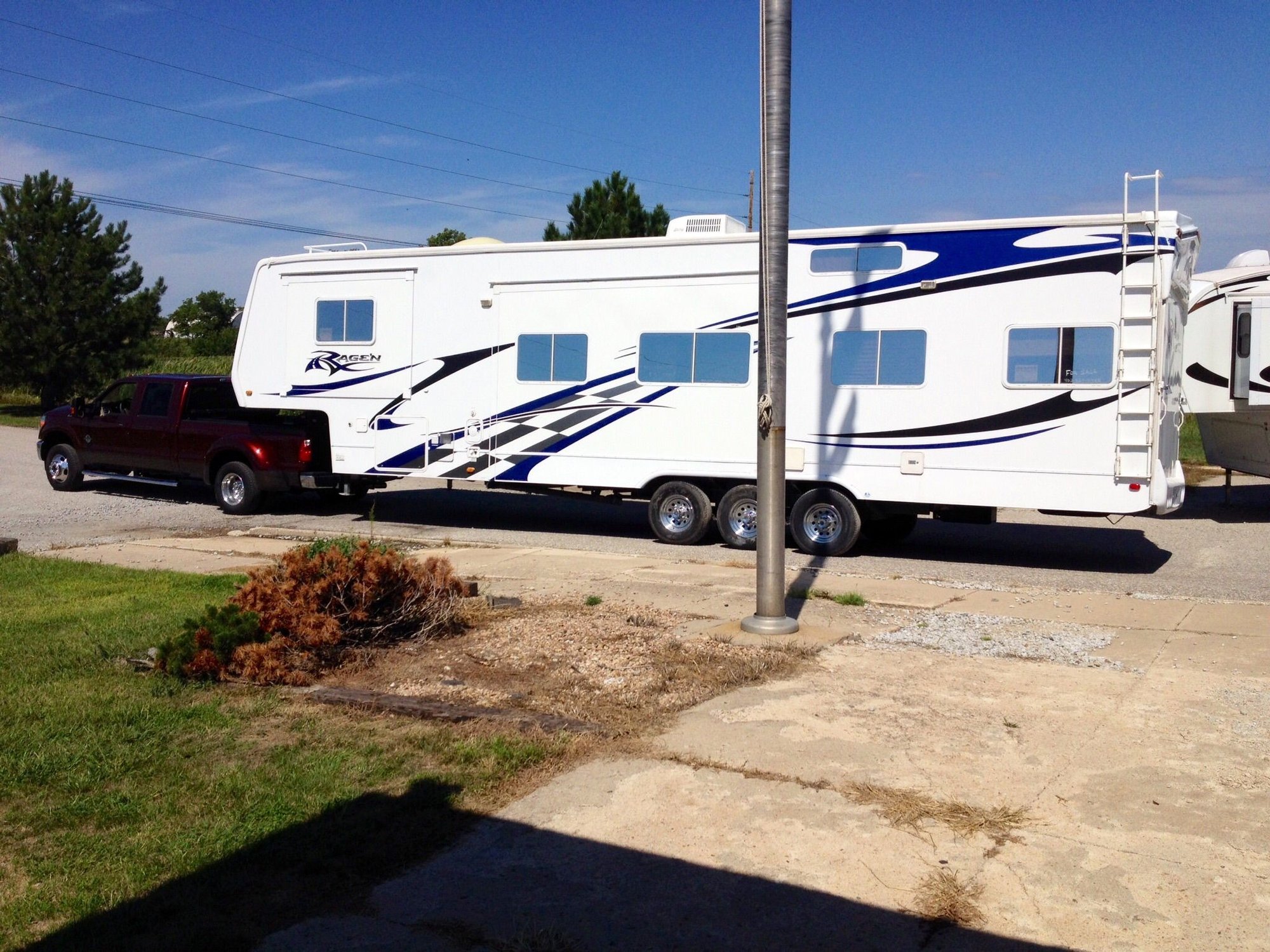

I pull a 41 foot raptor, just under 13000 dry....I have t weighed the pin, bit going to guess right around 3000........do I "need" air bags....probably not.....but I will probably install a set of air lift 5000 here soon, just for the added stability.
I have not got my pin weight yet, but my rig is very similar. I do need the bags to get the truck level again so I can get my headlights out of the trees.. I bought the Air-Lilft Ultimate 5000 with Jounce system (not yet installed)...
