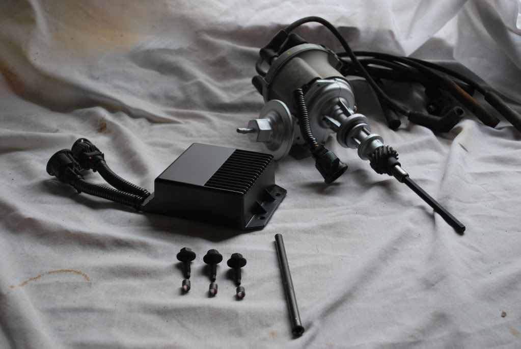

I'm guess by "electronic coil" you're actually talking about a Ford electronic ignition system?
Duraspark ignition came out in 73 but, if you're looking for a (better) Duraspark II ignition system, you'll need to look in the '76-'83 model Ford trucks with a 300 inline six cylinder.
I haven't installed my DS II distributor/module/wiring/coil in my '69 240 yet, but, I have a setup from a Ford truck 300 I got in my local wrecking yard.
There are some modules with Yellow or Red plastic wiring strain reliefs. The one to get is a module with the Blue strain relief.
Duraspark Upgrade
