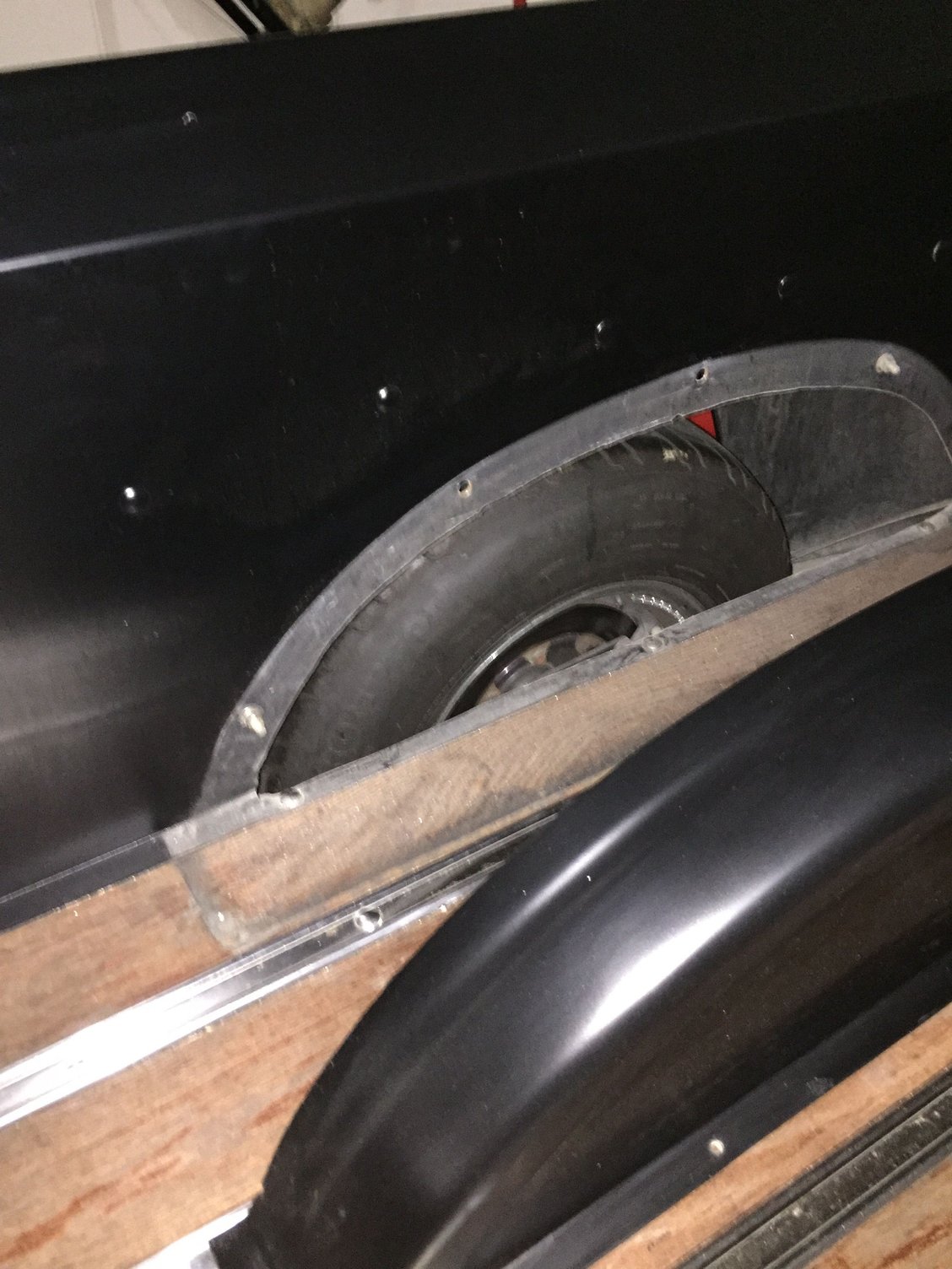

The previous owner put fiber glass wheel hubs in the bed of the truck. They are warping and look bad he also cut holes in the side panels. I don't know why there is plenty of clearance for the rear wheels with it not being cut. My question if I just wanted to replace both side panels are they just bolt on? There is no welding?

It is a 1955 f100. I have looked at the wheel tubs and they are more then bed sides so that is the main reason I am looking to put new on.

To answer the original question; the original bedsides are riveted to the front panel. If yours have been replaced they may have been riveted, bolted, or (rarely) welded at the front.
In the rear they were held to the cross-member by the tailgate hinge bolts. If they've been replaced, they may simply have the tailgate hinge bolts holding them, or again they may be welded. A lot of folks weld them at the rear for more lateral strength.

Actually, at the rear crossmember there are many spot weld between the crossmember and stake pocket to help hold the bedside vertical. Because of the stresses involved with doing that job, over time those welds break down, which causes the sides to fall over and have owners using creative and alternative methods of bracing to hold them up again. Swapping out a bedside is not a bolt on job.
