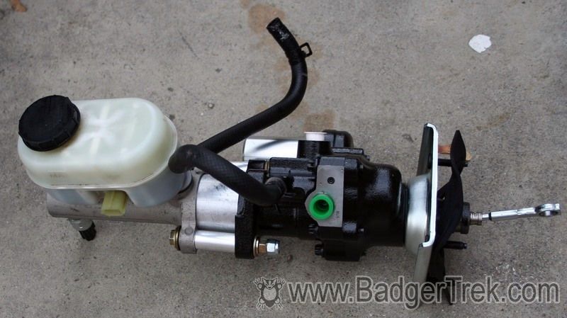

On edit, here's a picture of a master cylinder and hydrobooster combination although not from these trucks. The hydrobooster is to the right and black in color.
