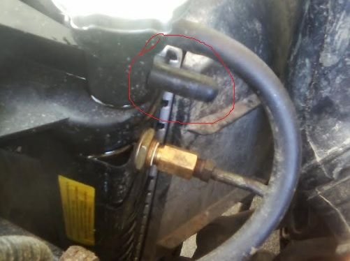

Just installed a new waterpump, now I leak from the rubber stopper located under the radiator cap, I think its to relieve pressure. What are some reasons this is leaking? Thanks guys.

Aftermarket radiators all come with a connection or two that not all vehicles use. Your truck don't use that port which has the rubber cap on it, but there should be a hose clamp around it to keep it from leaking.
Put a clamp on it and you'll be good to go.

The second port was used for the throttle body warmer circuit. I would assume that has been disabled since that port is open on the radiator.

I hate those plugged ports. They seem to always leak. The "stopper" is called a bypass cap. I always carry a spare.
