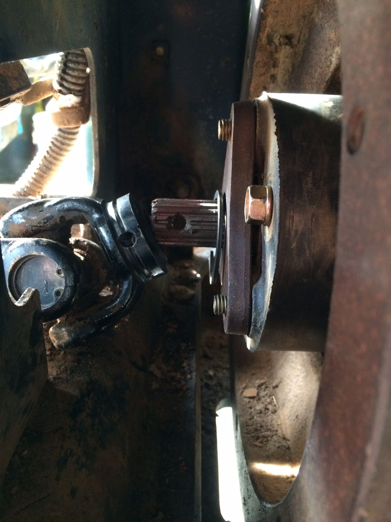

Well, thanks for the confirmation. I'm in the process of replacing a $650 drive shaft on my tractor because the grease fittings on the U joints were hidden under the foot plate. I'd have greased them if I knew they were there. I didn't even know the main shaft was under there, never seen it before, it lasted 850hrs though. But one of the U joints partially seized and caused bad vibration so I went looking.

Hmmm, I guess we can start talking about build dates?
I have none, truck built early October/14
And yes, JD 2210. Drive shaft from flywheel to transaxle is under the footbed. With the shaft installed you would need to remove the footbed and use a special needle type grease gun tip.
It's much cleaner now
