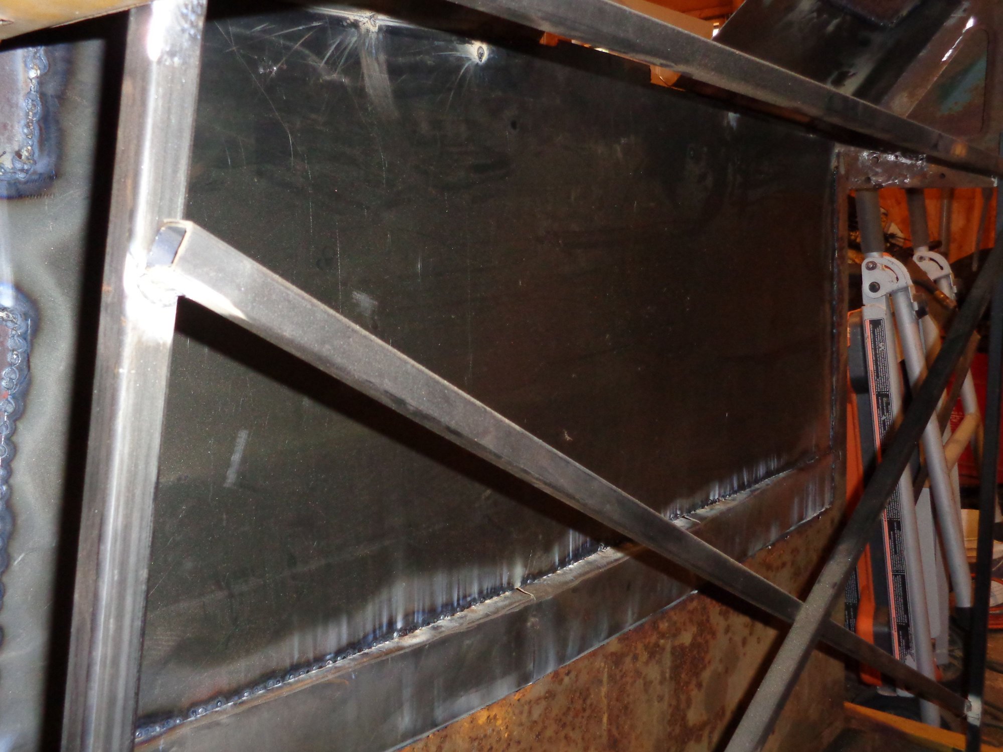

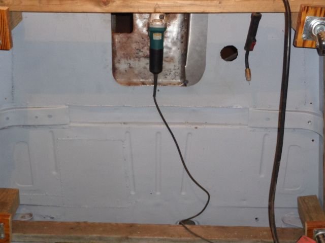

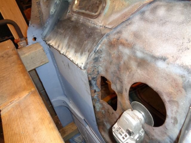

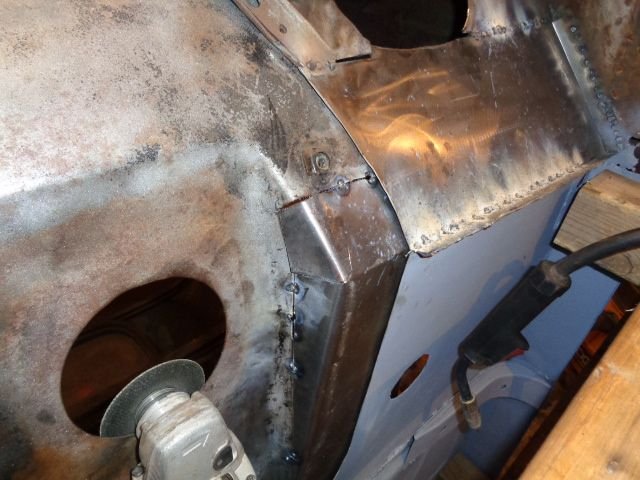

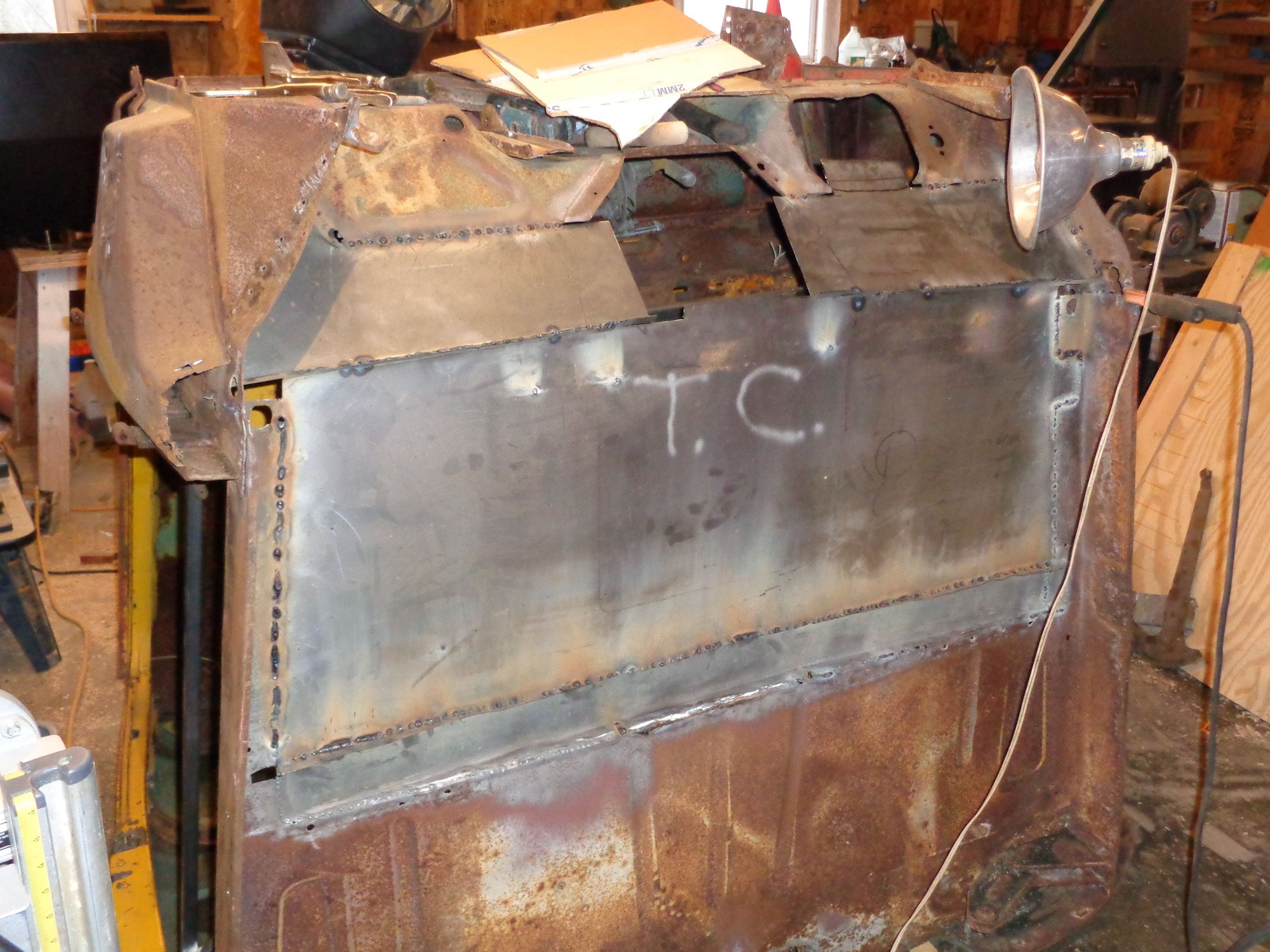

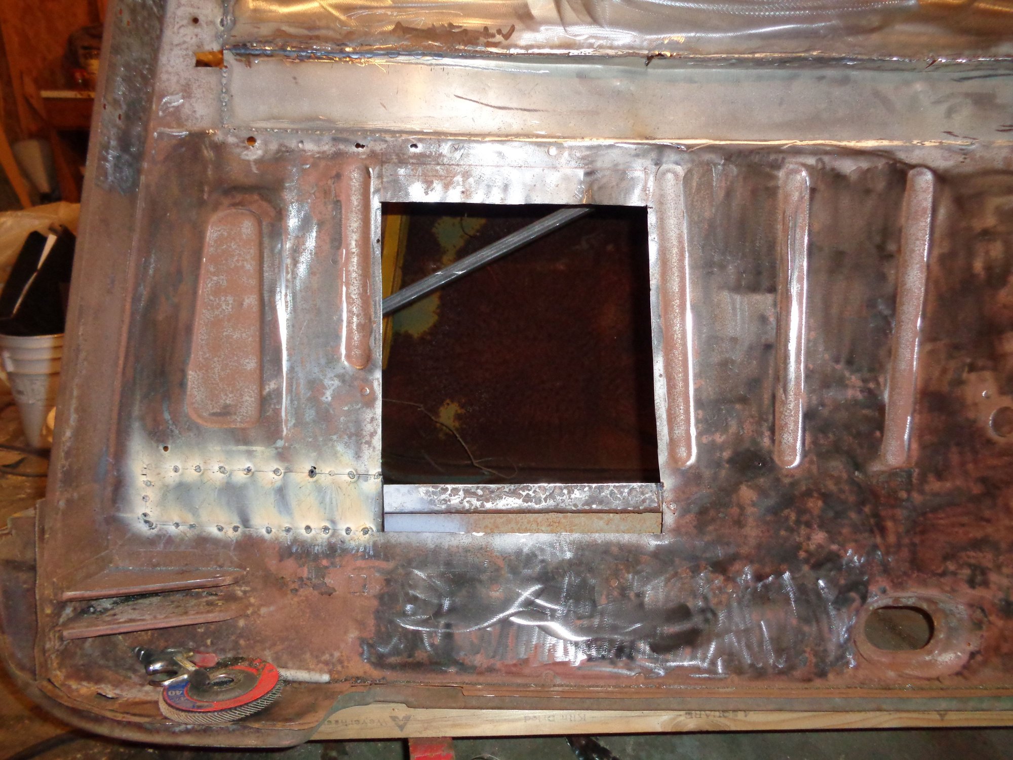

Old Apr 18, 2015 | 09:30 PM
toby tough's Avatar
toby tough
Joined: Sep 2011
Posts: 1,409
From: Clitherall, MN.
Decided to replace the rib in the middle too.
Looking good so far
Found some more rot after blasting a bit
The rust keeps going and going.
Trans cover fits good after a refit of the floor
Drivers side of the cover was toast.
Tadah.
Well I've made some progress sort of. Had the floor all welded together and was wodering how the trans cover was going to fit. 3/8 gap on one side and5/8 on the other. Uggh. Chop chop, grinde grind. weld weld. All is good now. Disregard the junkie back ground . Time to drag it outside and blast the heck out of the rest of it.
