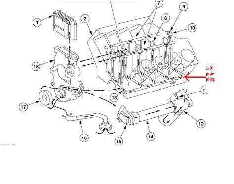

I took my pressure tap from the 1/8" pipe plug in the left rear corner of the block. It reads the pressure after the filter and what is going to the rods and mains.
