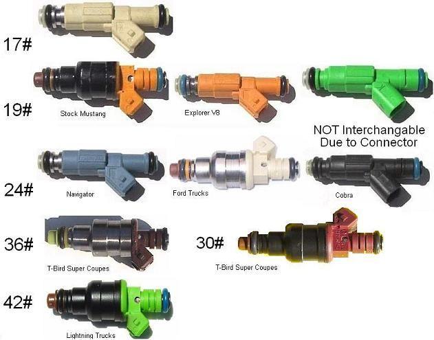

Here is the injector guide I found. This is what I have used and it seems to be correct.

That works to identify the injector to which lb'age it is (if that's a word lol ) but I'm more concerned with the spray patterns between the single hole and 4 hole pintle's also if using the 4 hole if that will affect anything.
But nice photo. I will be saving it!

You asked if they were 24lbs or not that is why I posted it.

Yes that was one of the questions, thank you and I saved the pic lol.
