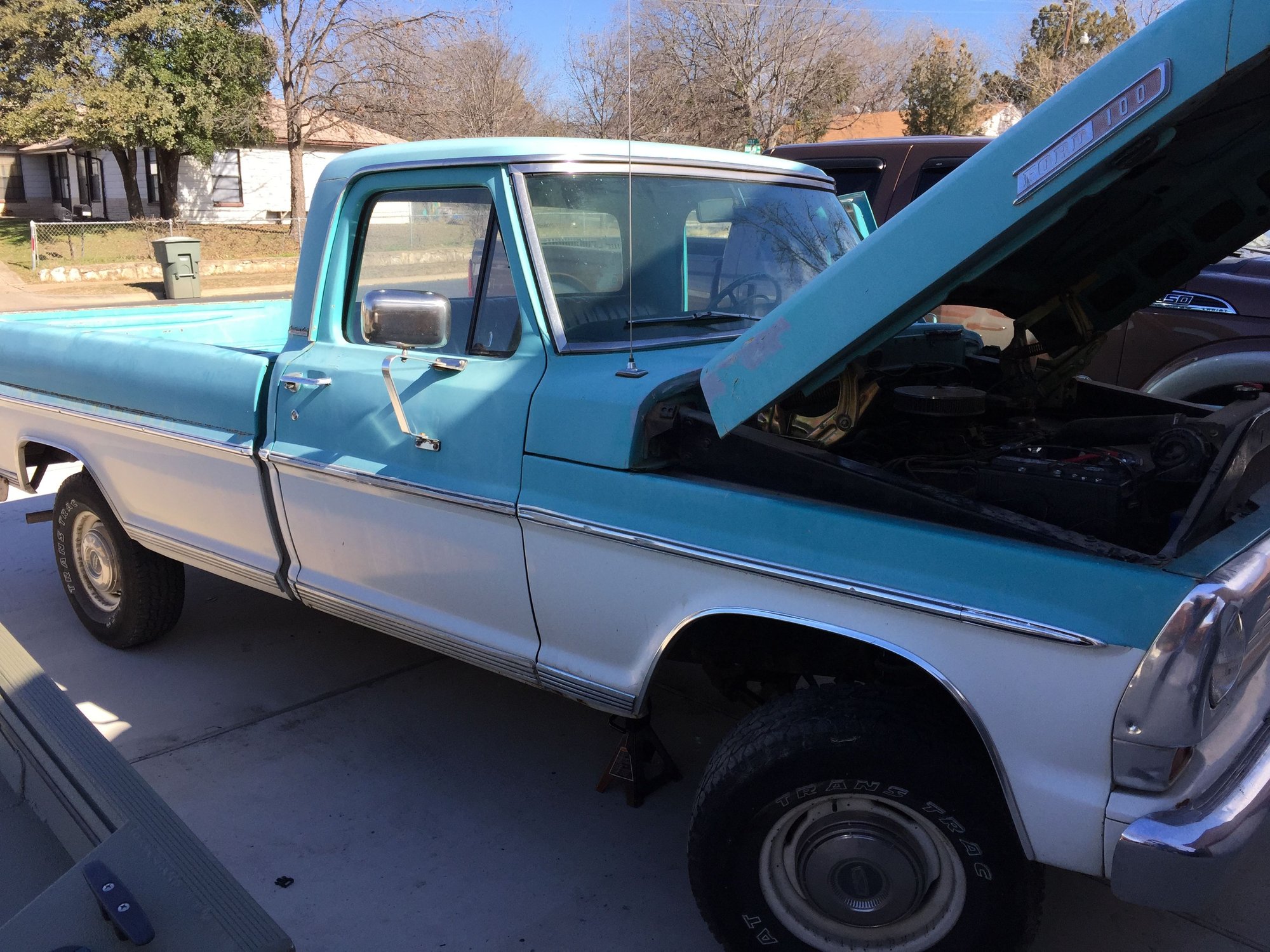

Compression tested the 352 in my 1967 F100. Averaged between 90 and 125psi with most in the 115psi range and two cylinders at 90 psi . So looks like a rebuild is in order. I'd like to upgrade it while its out, is it worth messing with the stock heads?

Well I want to freshen the engine up anyway so this just gives me the excuse to do it sooner I picked up this truck for $1300 and I have set aside some funds to do the engine knowing it would likely need a rebuild before a 4bbl and some headers :-)

Nice truck when you say freshen up are you going to do a full on rebuild?
