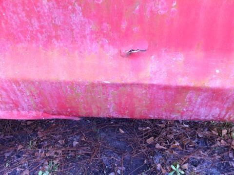

I have two options but dont which is better (if their is such a thing). I currently have no bed ... zero .. zilch ... nada. So, my two options are to 1. buy a'78-'79 bed and repair it or 2. buy an '80-'96 bed(because the outer skin is the only difference) and replace the outer skin. Option 1 is cheaper but more difficult and has a longer project time while option 2 is faster and easier (a relative term here) but much more expensive. So basically I'm asking is the price difference worth not doing rust and dent repair? Here are some pics of a bed I found in my town.

Foofees,
Option 1 is my choice. I did this to my 79. I bought 2 bed patch panels for $60 and went at it. Sand the inside of the bed floor down to bare metal and stand it on end. Start circling daylight wholes with a Sharpie. If an area looks like Swiss cheese, just cut a patch to cover as much as possible - the patch panels I used were 16' x 48".
I had to drill out a few spot welds on the underside rails for a few repairs. I used the drill/plug method with a self-tapper to get the weld tight.
It took me a full weekend but it only cost me around $90.00 (panels, wire, primer) to fix the whole bed. IMO Option 1 is easier than messing with side panels.

if you have a welder or a friend with one the box skins are much better than patch panels PERIOD! I will be doing a how to thread on box skins using basic tools most have or can buy cheap in April. Ive been in auto body and welding and fab work for over 35yrs. If the floors are decent,skin it.

The dent bed you are looking at does not look bad. Not too hard to fix. I fixed my OE bed that looked worse with patch panels. Still, I am interested in the "how to" for bedside replacement.
