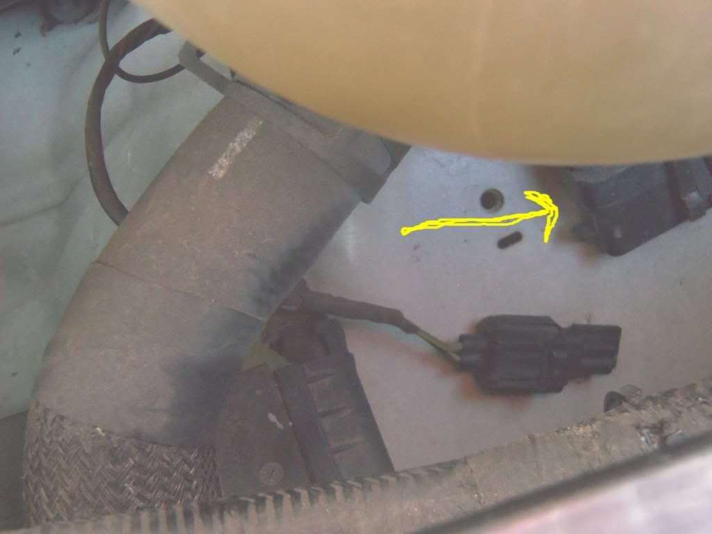

Before you go any further first check on the left/drivers side inner fender, just below the coolant reservoir for a plug looking like this:
This is that plug as it comes from the factory without VSC:
If that plug isn't present you will have to use an aftermarket VSC or CC unit/system.
Let me know what you've got and we'll go from there.

That plug is in fact present.

It is indeed---good news because otherwise you'd be SOL trying to fit the factory VSC to that chassis.
Now you need to search for the factory kit originally available or a reasonable copy of it. This would include a new steering wheel, clockspring, the throttle control servo and several cables connecting that servo to the throttle cam. I don't have the Ford part number for that kit but do be advised knowing your year is vital to buying the correct kit---they do NOT interchange across several years, at least not of your particular year.
