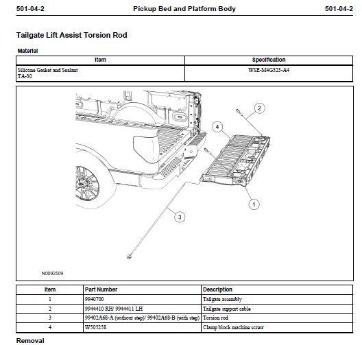

How To Fix The Snap Noise on Tailgate
Originally Posted by Tom
Hi everyone
My dad's 2010 F150 is making some funny noises when you open the tailgate. Has anyone seen this, and if so what was the cause? Seems like something is going awry with the torsion bar.
2010 F150 tailgate noise - YouTube
There are two 8mm bolts on the right side bottom of the tailgate that hold the torsion rod. With the tailgate closed, loosen the two 8mm bolts slightly using a short socket on a 1/4 inch ratchet, then tighten both bolts very snug. That should fix the issue.
I fixed a couple of trucks with the same issue.
