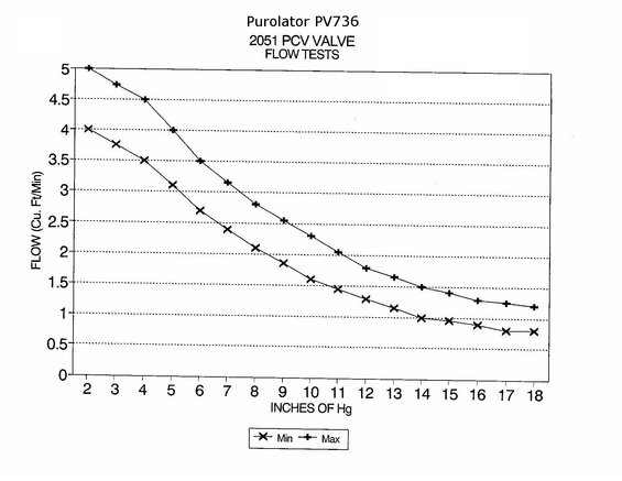

I will attempt to retrieve two charts provided by Purolator showing the differences between two PCV valves, both for the 300/4.9L engine.
PV736 is what was specified for a 1970 F350 300 engine w/o EGR. The scale is in feet/min.
PV118 is what was specified for a 1986 F150 4.9L engine w/EGR. The scale is in feet/hour.
[note: 300 feet/hour is the same as 5 feet/minute.]
My thanks to AbandonedBronco for his assistance with adding the charts. These two PCV valves were chosen due to the fact that I drive a 1986 F150 w/4.9L engine which has been modified with Duraspark/MSD ignition, no EGR and a carburetor from a 1970 F350.

So what's your interpretation of those two charts, F150, and what decisions can you make from them? Were those two valves made to flow differently because one is for an engine with EGR and one isn't? Or because something new was learned about how to do it over 16 years? Or because emissions regs got tighter? What's in the charts that says that if you modify a 300-six you should choose only from among valves that were made for factory 300-sixes? I see data, but no answers jump out of it.
