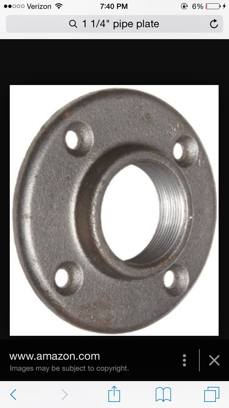

Ended up being the seal. I screwed up the first one pressing it on. Put on the new one and worked great. Used a pipe plate. 1 1/4" pipe x 12" long with a cap to press it on. Worked awesome.

I'm going to be doing this tomorrow. Got it all apart today. Did you buy that off of amazon or was that just for picture reasons? How hard was the old seal to get off? I beat it up for about 45 minutes and gave up after nearly destroying its shape and it not budging..

The old seal was tough. And no , not Amazon just at the local plumbing supplier. I bought a pipe plate, 12" pipe and cap. Worked greAt. I wasn't sure if I was doing the right thing either taking off the old seal. But I finally got it. Dust seal was easy.
Oh and when putting the axle back in I found the best way to put it in was to place the axle in just enough to start the hub assembly on, then bolt hub assembly on to press it in. (Puts it at the right depth)
