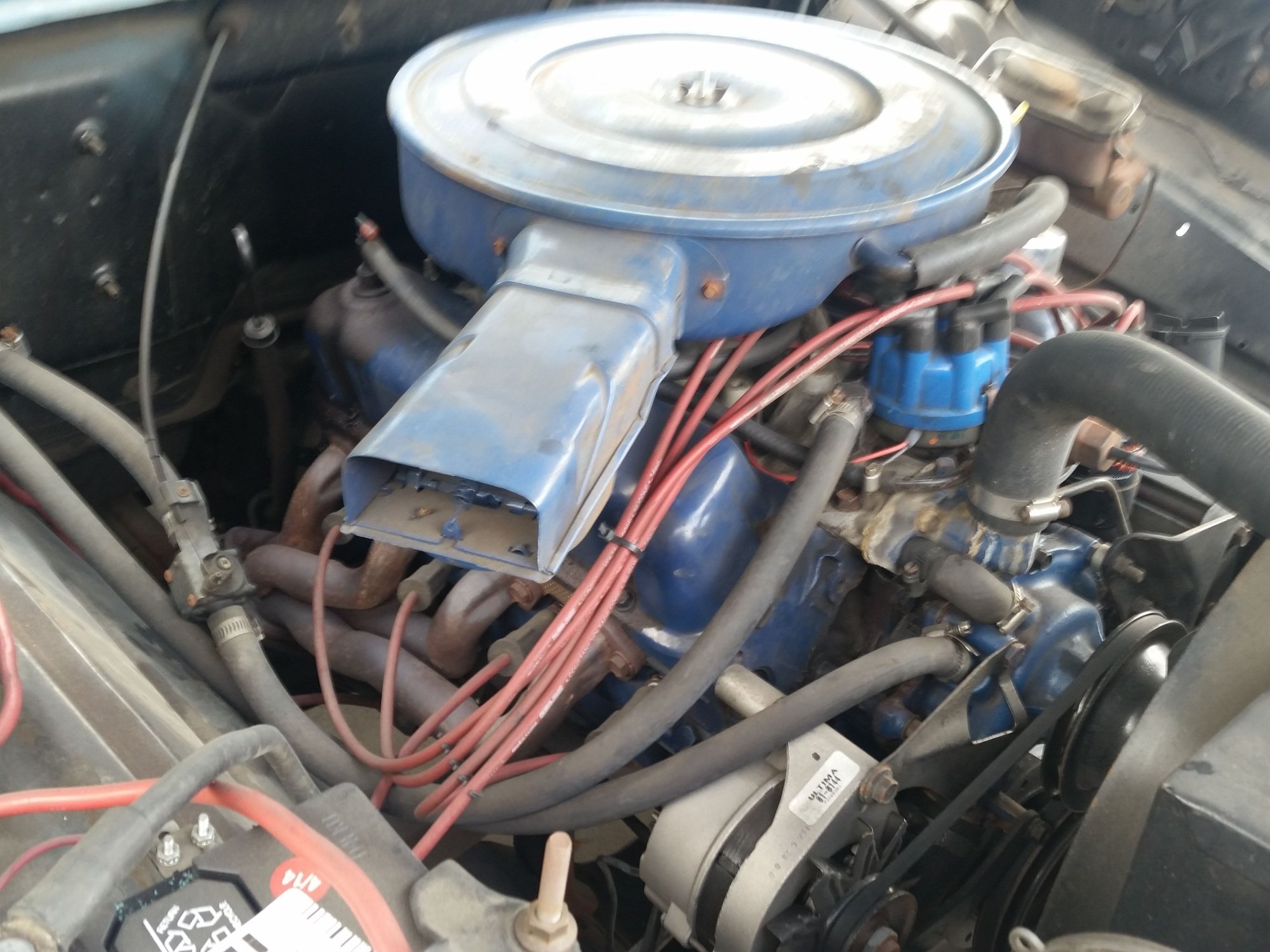

OK thanks. I think it's a Dana 60. I'd post a picture but I can't figure it out how to post pictures. Is the Dana a OK rear end or should I look for a 9"? Figured it out I was on mobile site

Looking pretty clean, especially the rear differential. I would guess it was put in at a later time. Looks like it has a lot of Ranger chrome without the side chrome along with a 67 grille. Either way, its a very good looking truck. I may be wrong, but it looks like electronic ignition wires leaving the distributor? If so, thats a nice upgrade. When you said lowering kit I was a bit scared, but the truck actually has a nice stance to it. I am not familiar with "DJM lowing kit", so I hope you are able to resolve the vibration issue. Like I said, you chose a good place to get some good 67-72 information.
