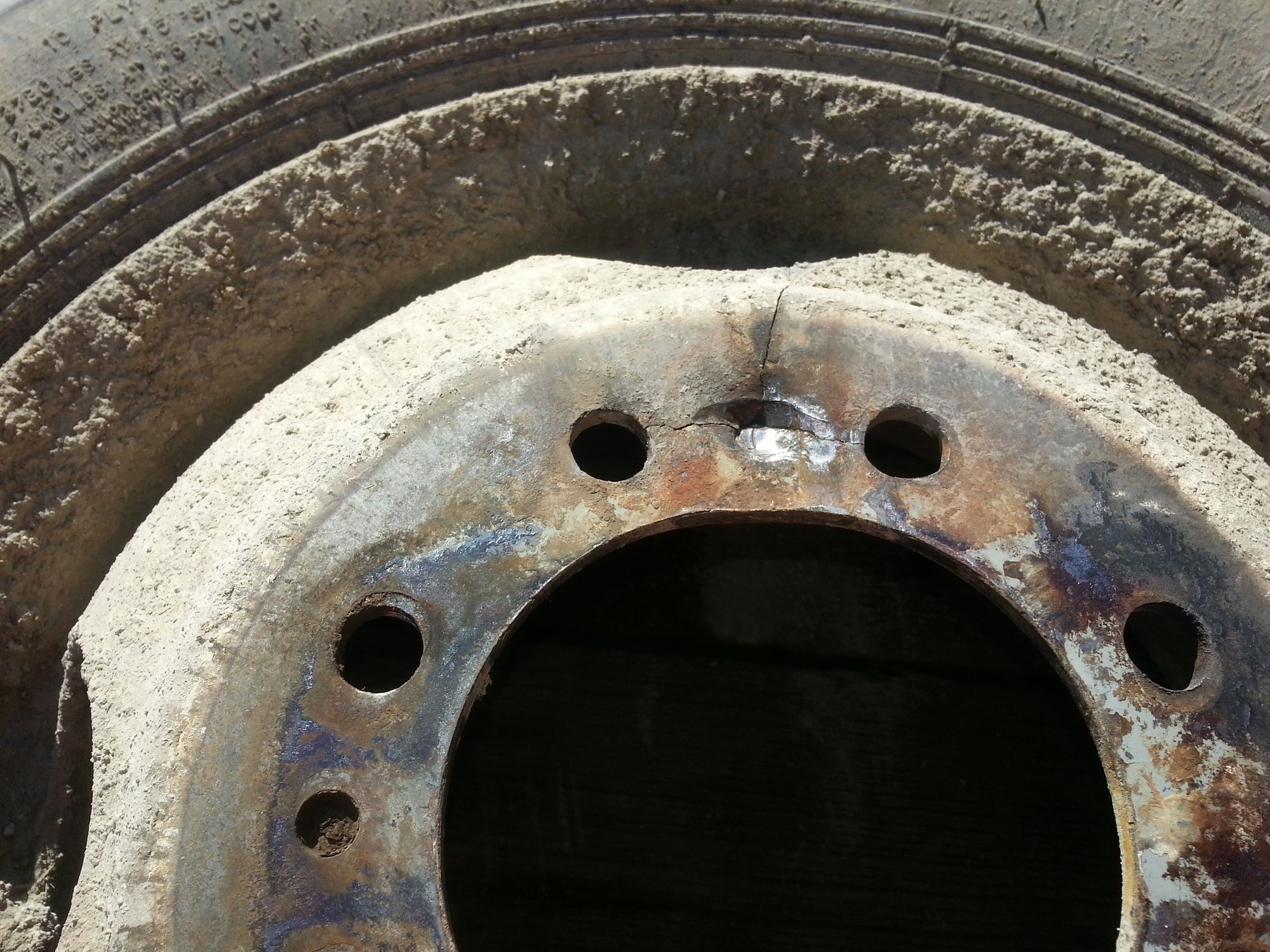

Took my truck to a local tire place because I had a flat while in town (limped in on one dual). Noticed a couple days later that 2 lug nuts were missing. When I went to replace them, I saw that the outside rim was cracked! Upon further review - BOTH rims were cracked!
Take a wild guess on the cause....
Cracked F-350 Dually Rim.

Christ! Did somebody shoot it?

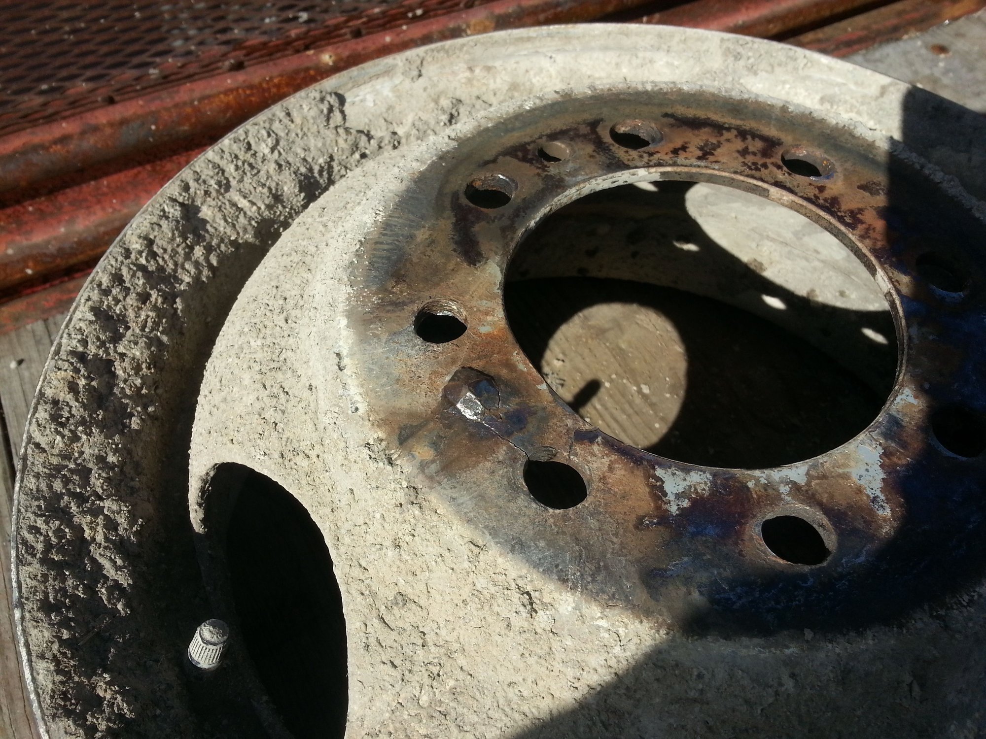

Here is the inside rim...
Evidently, the guy installing the tires forgot (or didn't know) that there are alignment pins on the rims. He torqued it down (with the air wrench) so hard, that it mashed the nipple, bent both rims, cracked both rims, and generally ruined my day!
So far, the tire place has agreed that they owe me a couple rims. I asked today, and they are ordering new ones since they cannot find a set of good used ones......
At least they are standing behind it.

Mounted with something lodged between them?
Old Feb 19, 2015 | 09:37 PM
Amish Ford's Avatar
Amish Ford
Joined: Feb 2015
Posts: 264
From: Northcentral Missouri
You can see in the photos that the rims were actually mounted 1/4 turn from where they should have been. The holes and what's left of the pin, don't line up....

All that "crud" is just road dirt. It accumulates in just a day or two....wet or dry.
There is no pin on the axle - the inside rim has a pin that goes into a hole in the hub.
