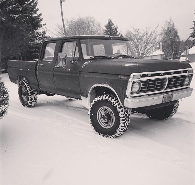

This is how my truck sits currently. Stick with 35 12.5s
