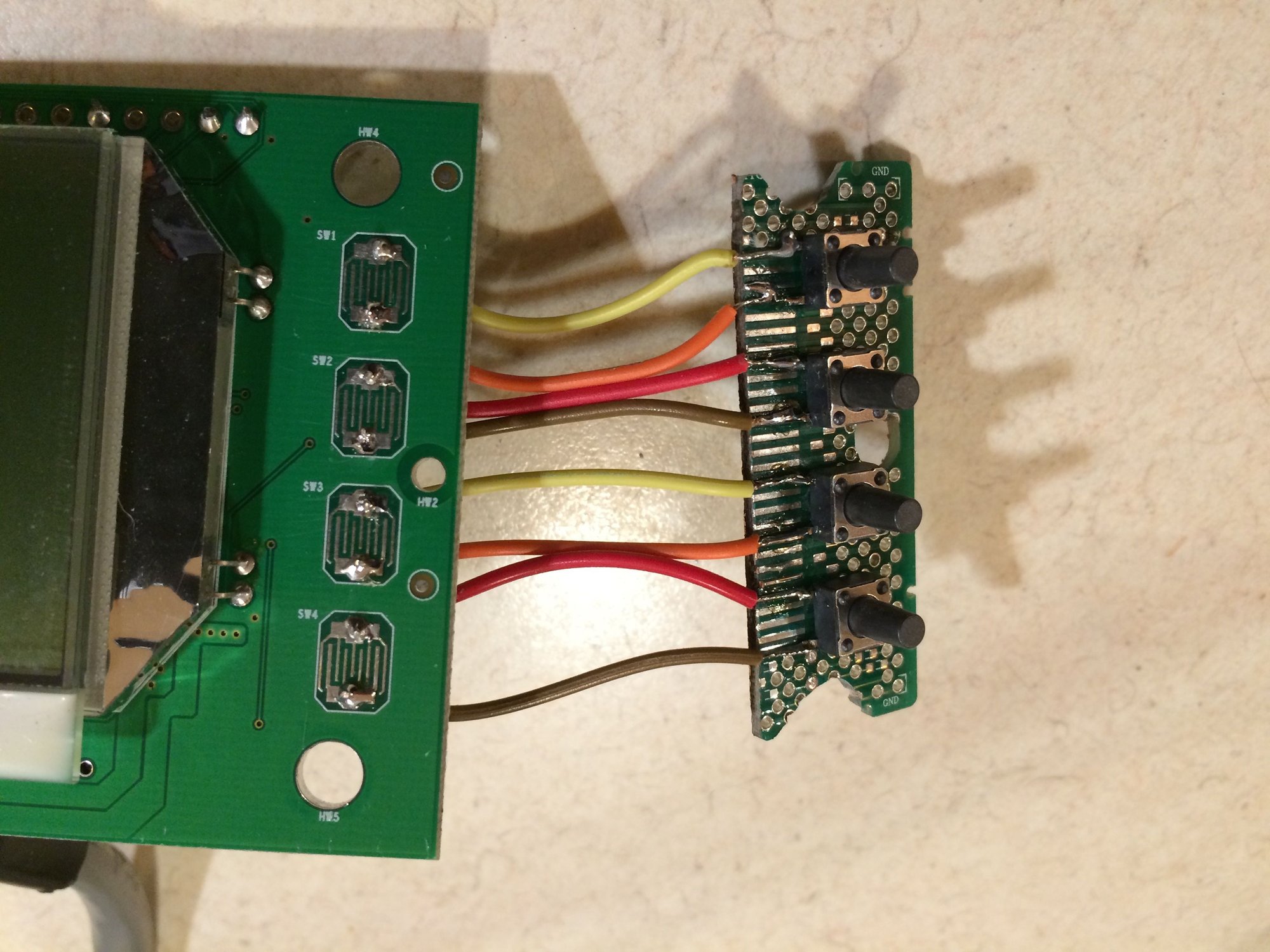

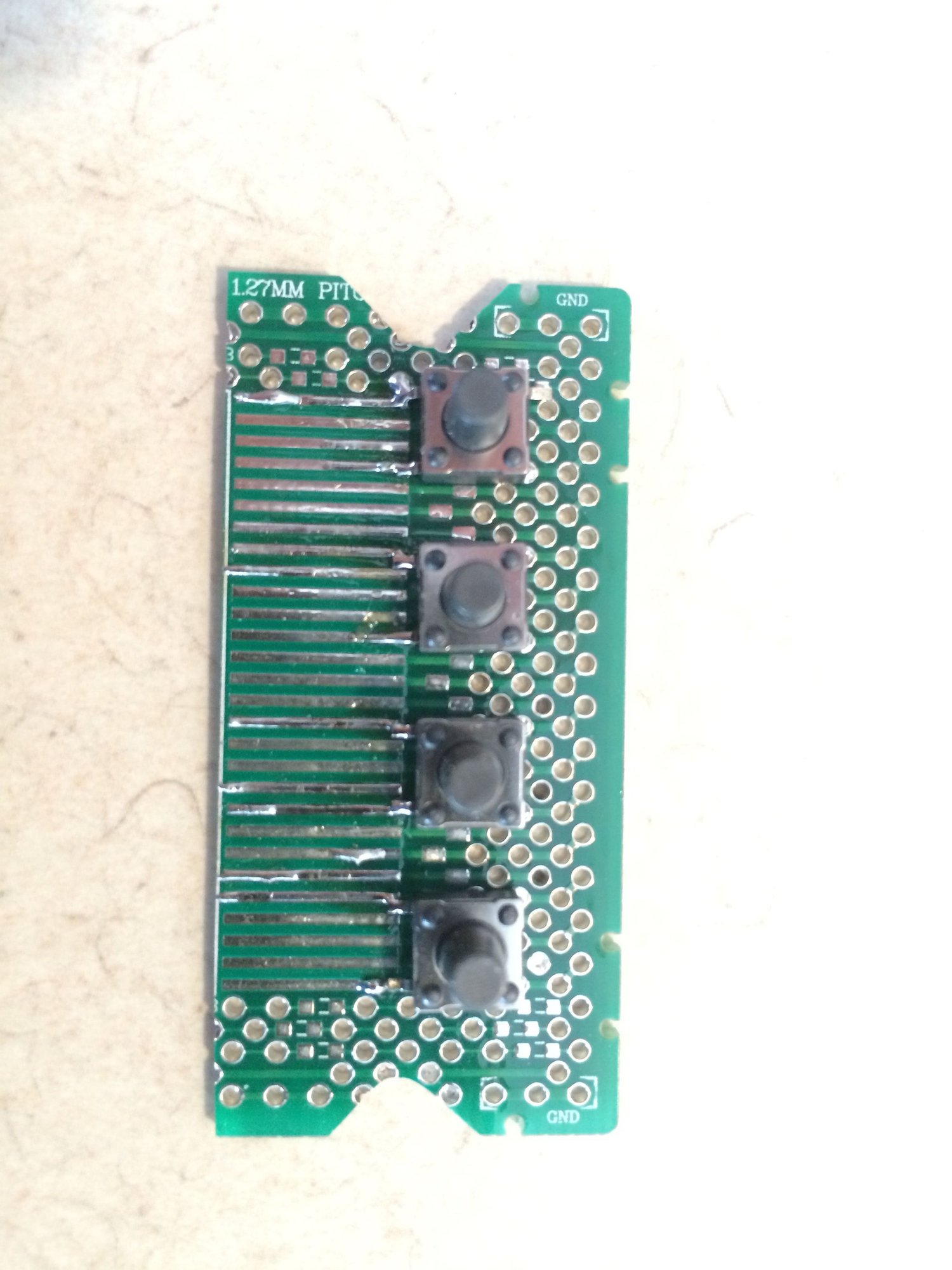

I used 4 tactical switches which were SMD mount (Got them from the now defunct Radio Shack), along with hacking up an SMD board for the switches in stead of the common soldering to the actual board. Also ground down the inside front cover where the old buttons sat to be flush with the rest of that location (you will see in the photos).

Schmart Board 4-56 Pins 1.27mm pitch - 202-0004-01 Rev A. RS - You can get from SchmartBoard Home Page

The Schmart Board was cut in half and then ground and drilled where needed to clear inside the case.

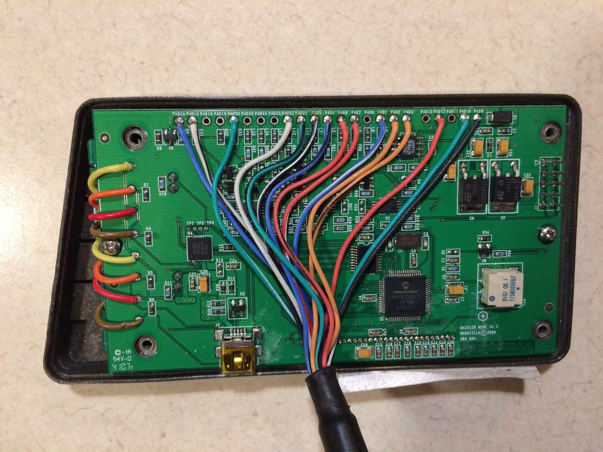

Unmodified Quadzilla Commander main board - back

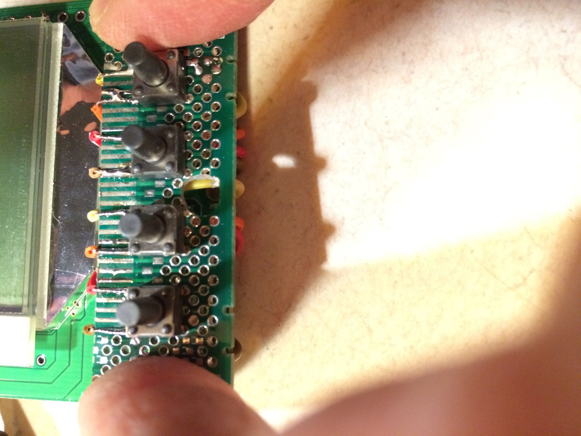

Custom button PCB

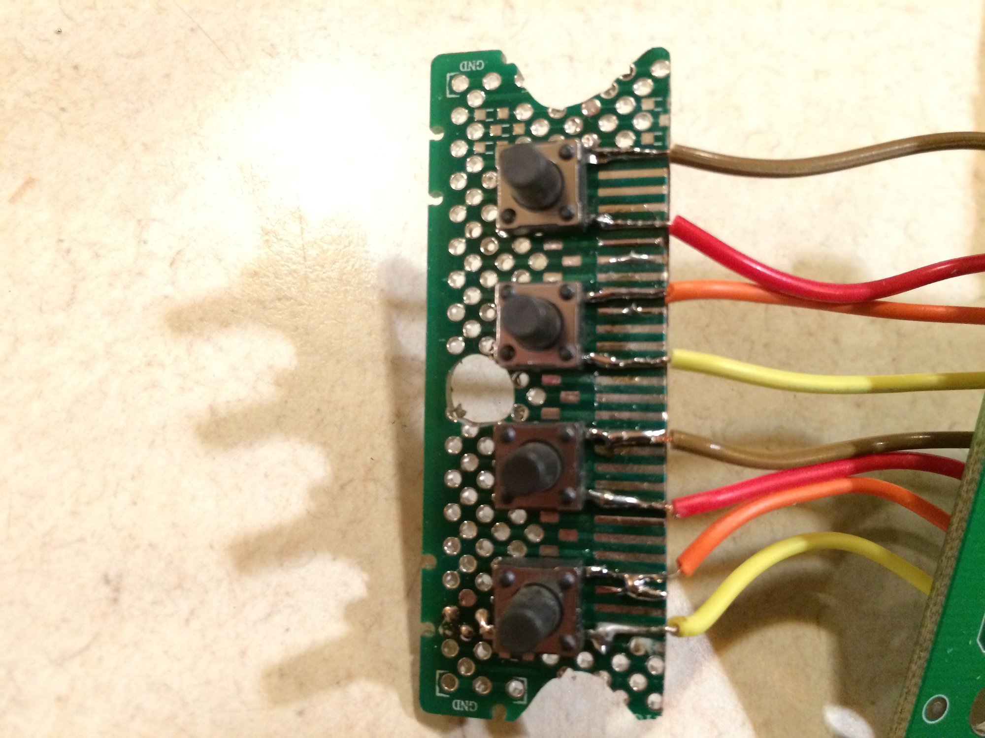

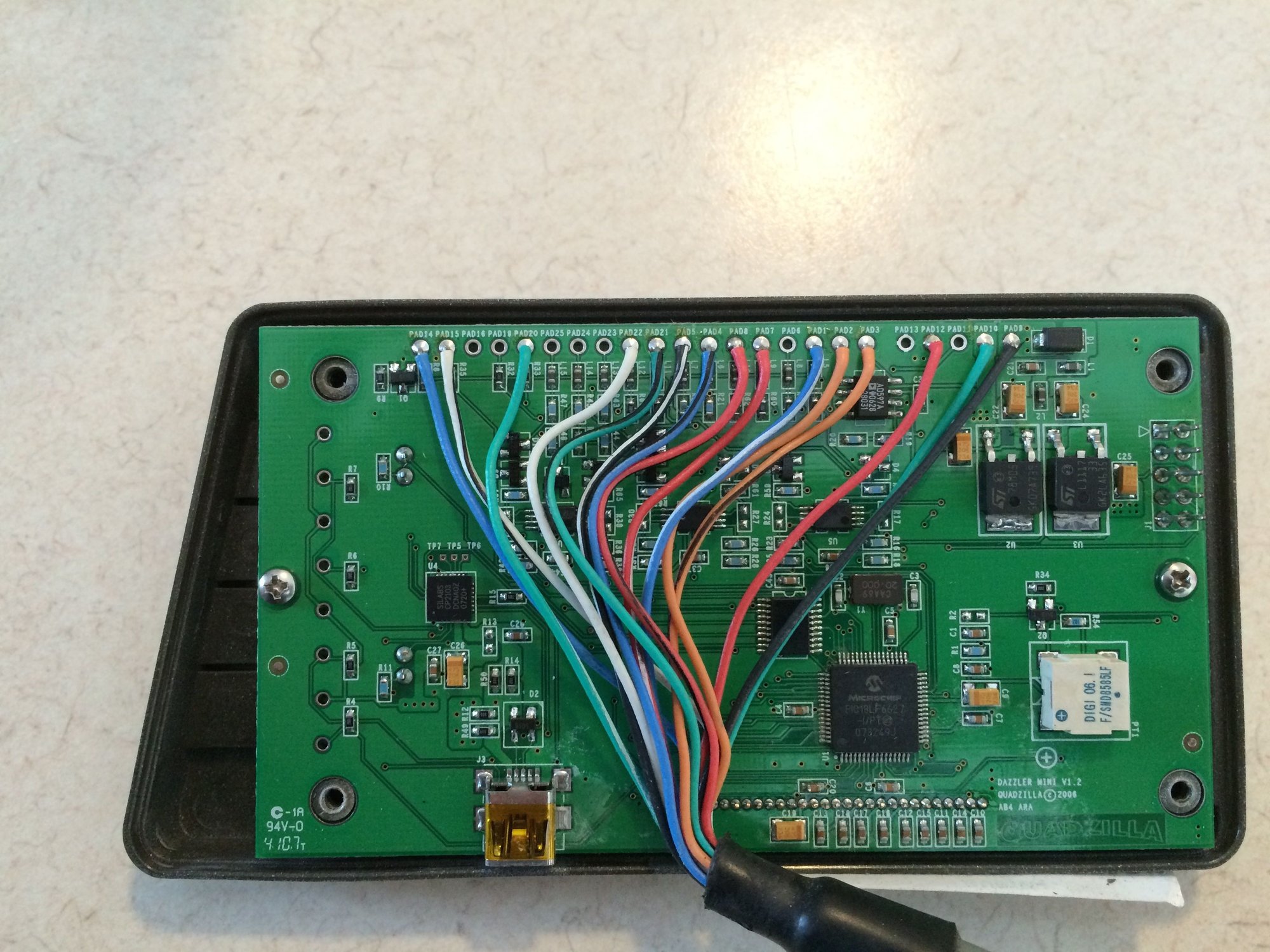

Button PCB attached to main board - front

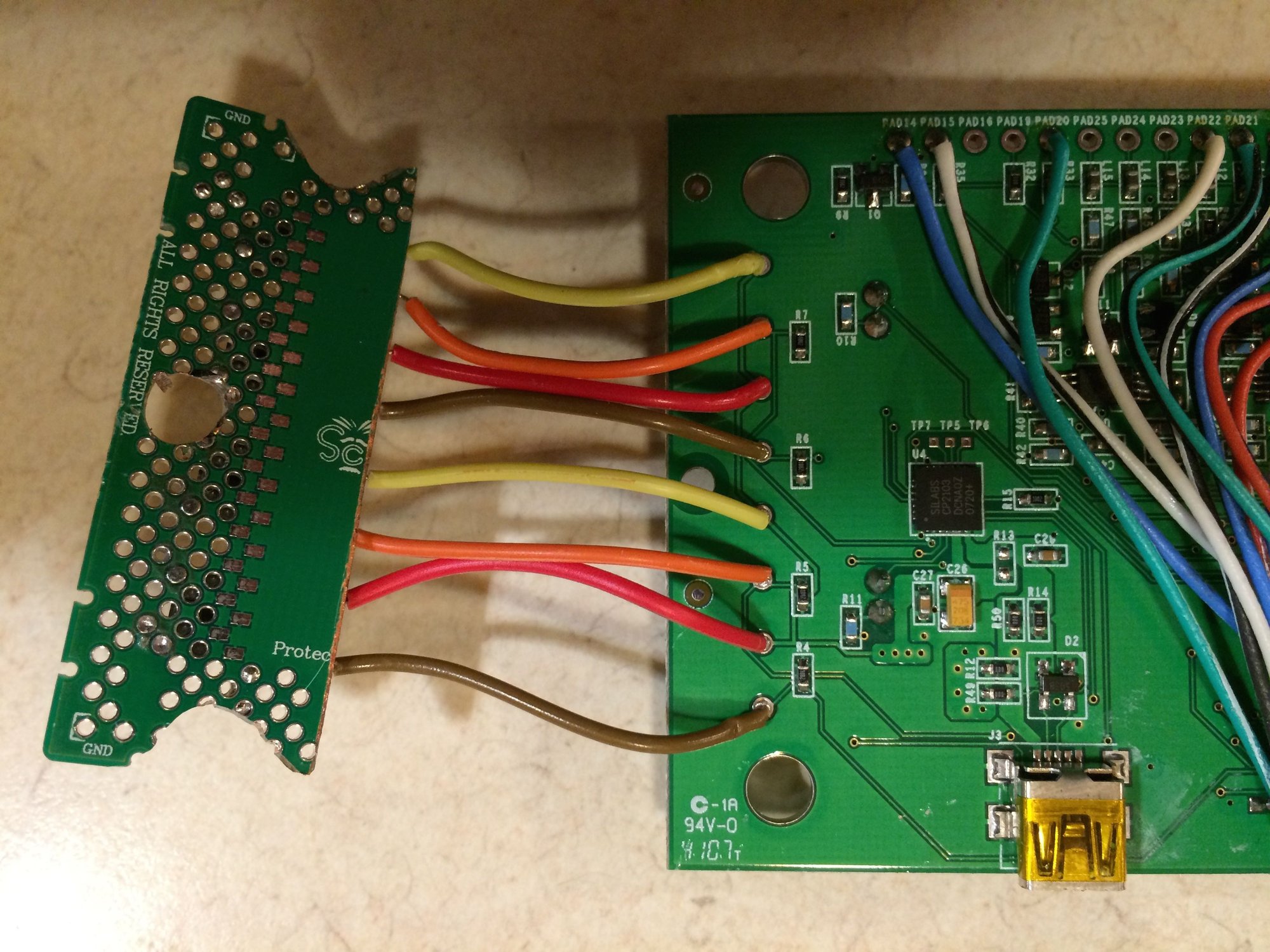

Connection from button PCB
Back of connections

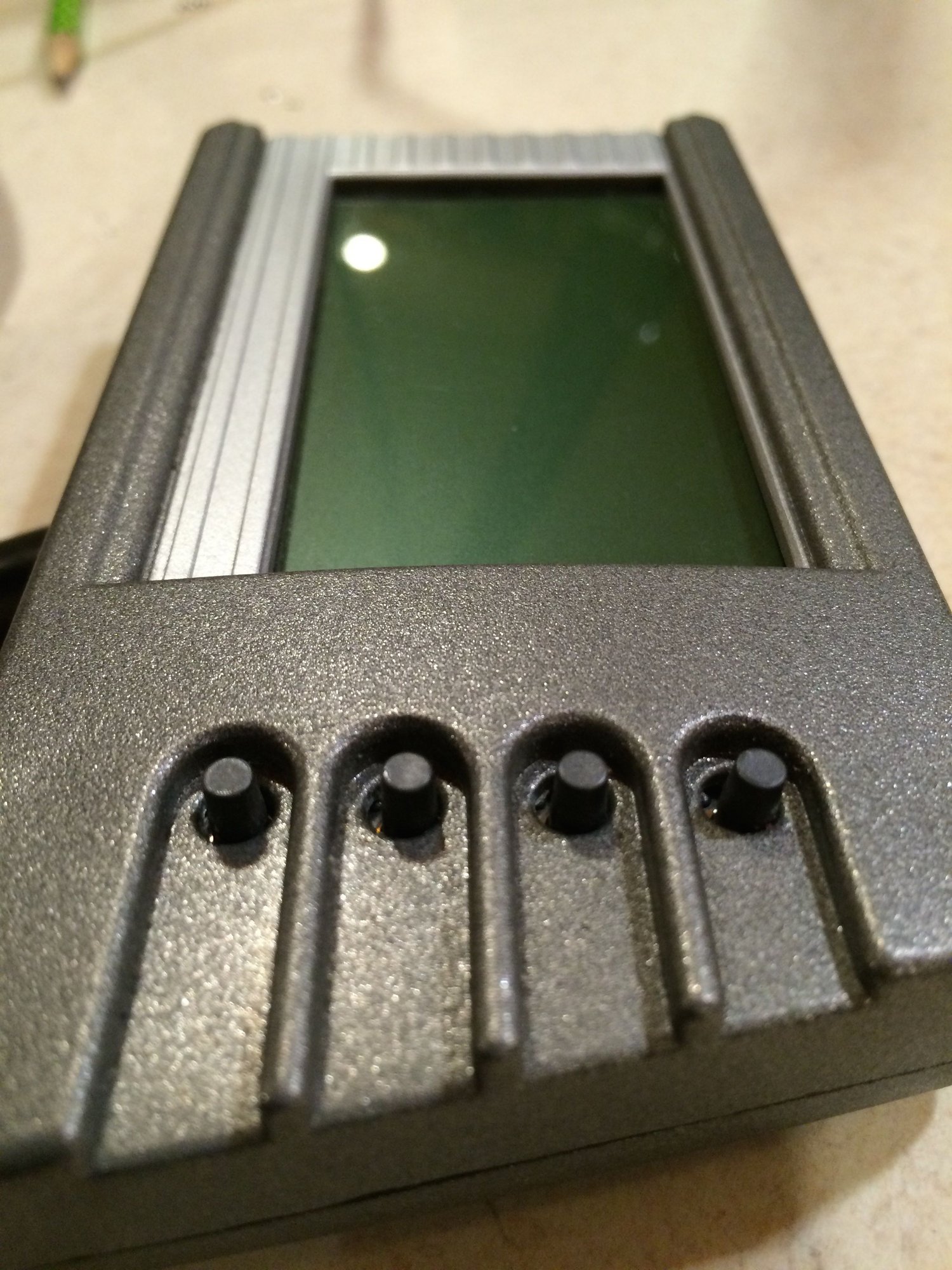

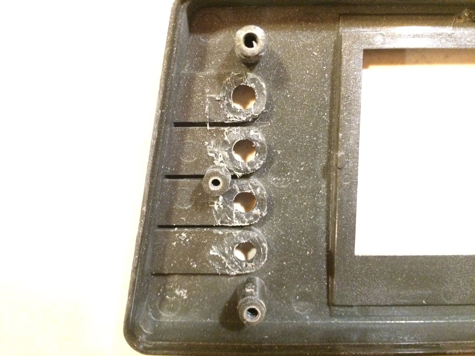

Modified front cover - I used a dremel tool to grind down the tabs
Aux PCB attached to front cover

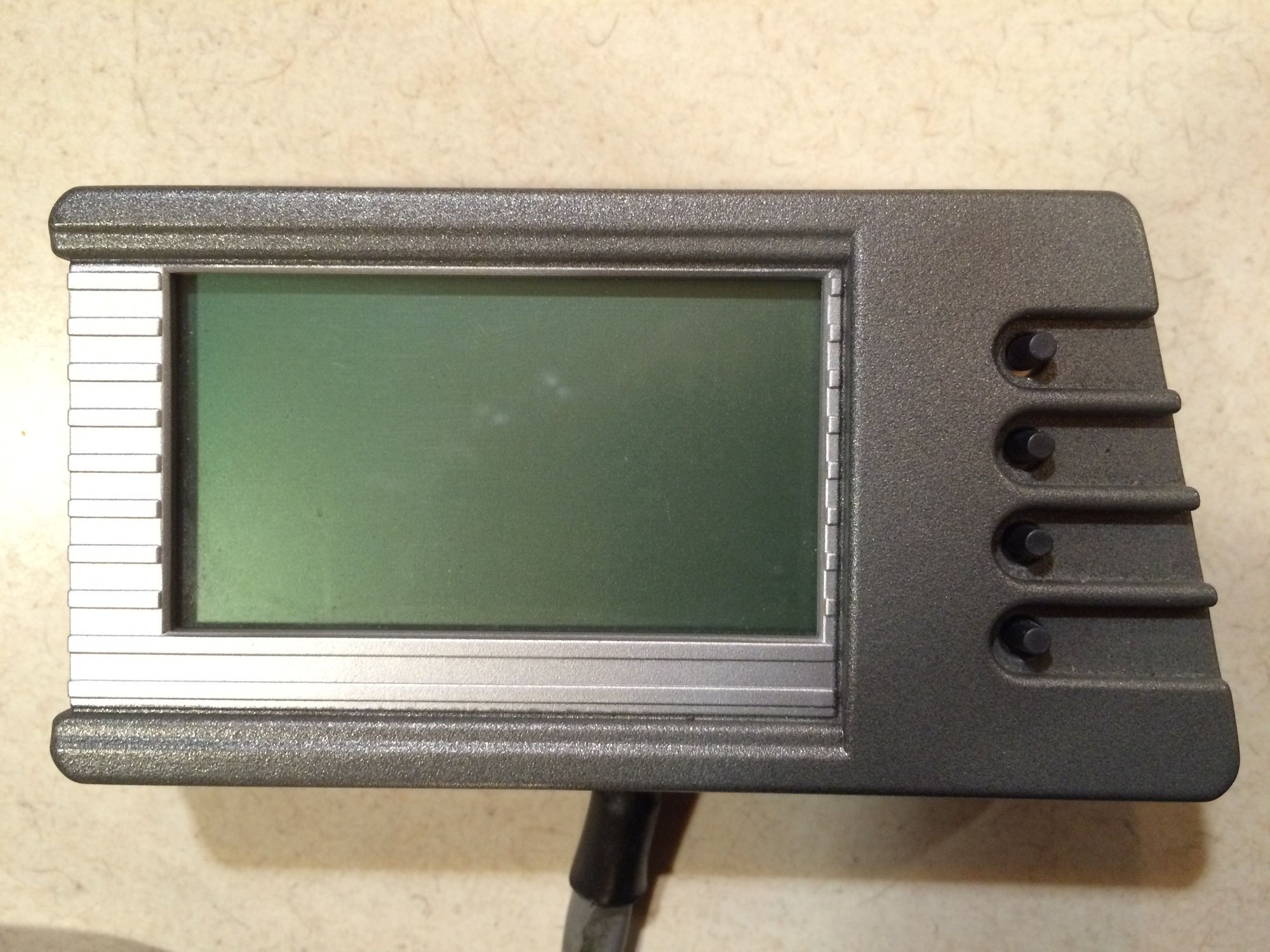

Front of modified Quadzilla Commander
Close up of replacement buttons on front of Quadzilla Commander

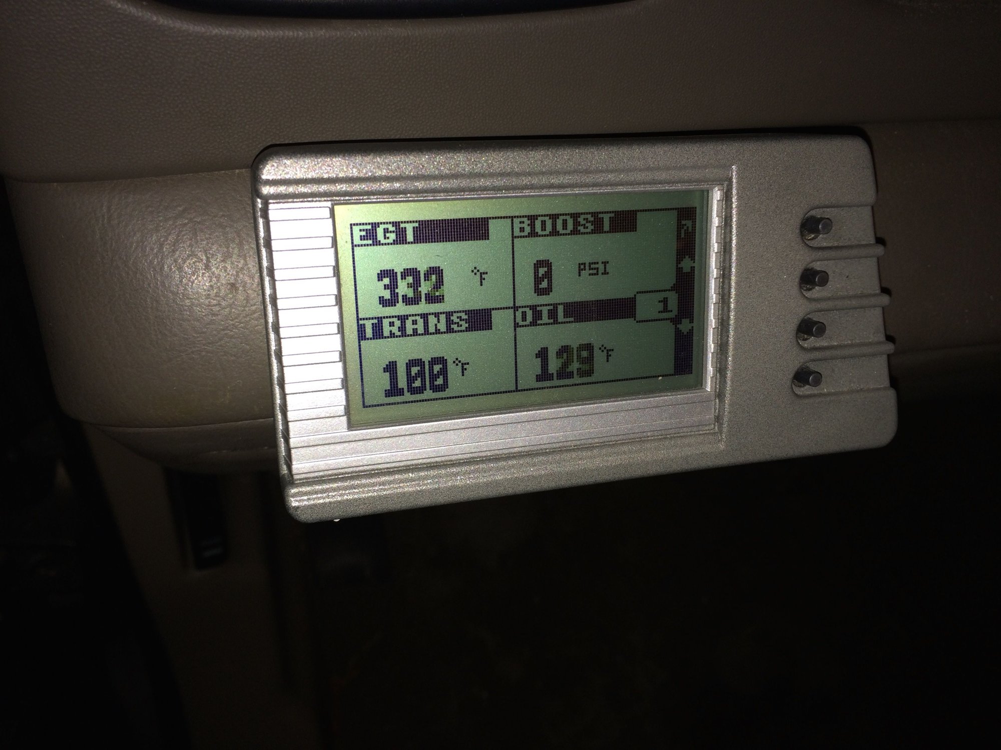

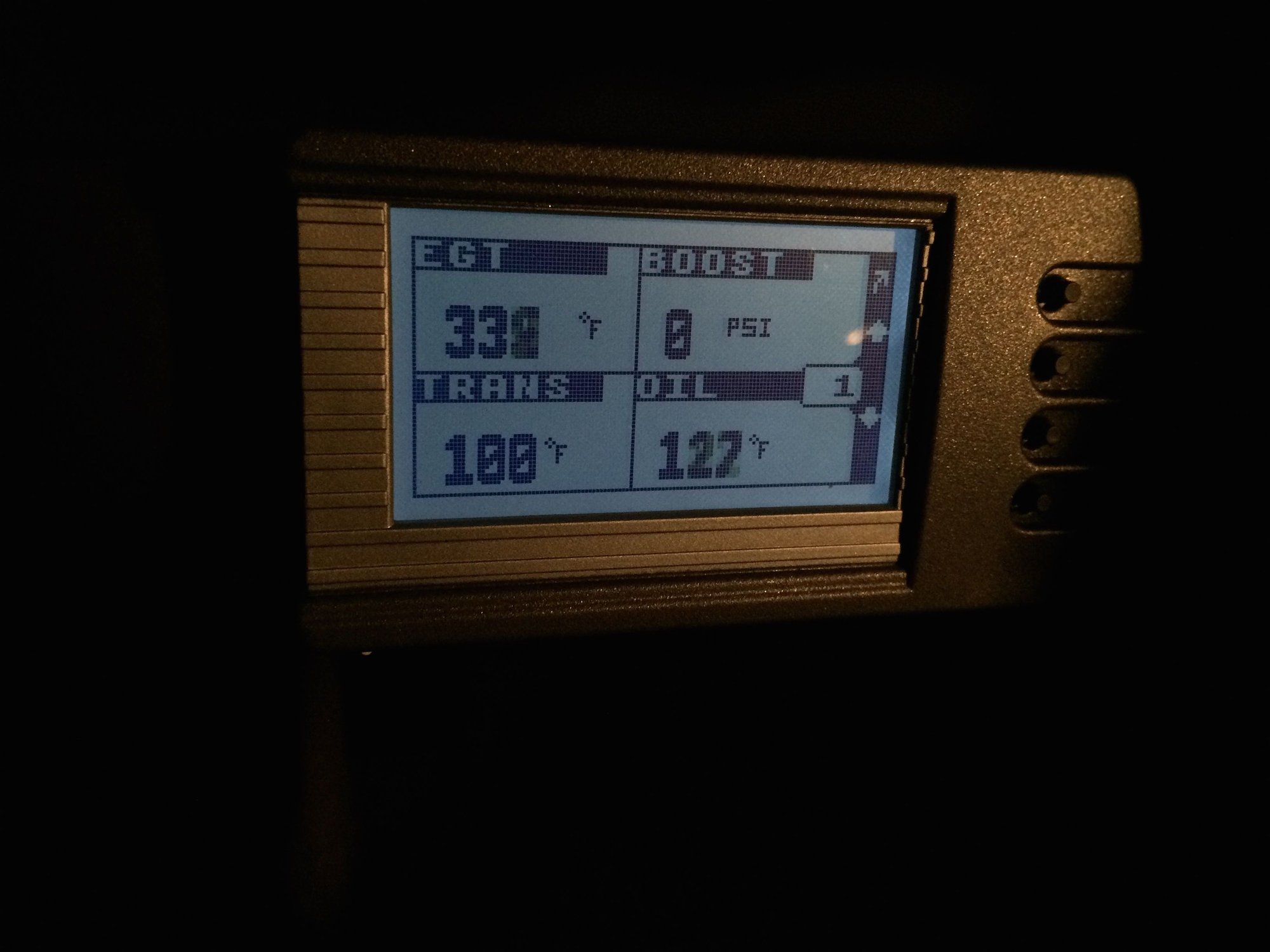

Proof it works
More proof it works with a flash
