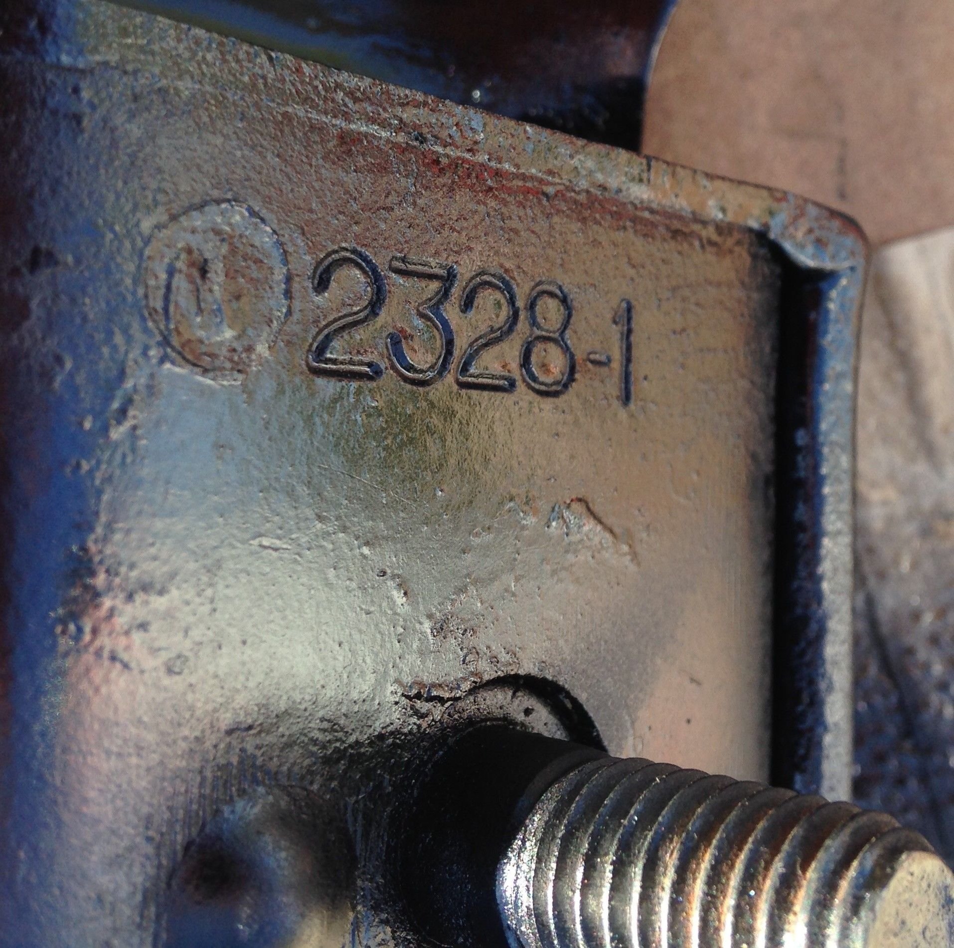

There were part #s on them when I had them off. I took a picture and somehow lost it on my phone. they were in a place on the mount that would have to be removed again to find it. I may have to remove one side again to find the #s.

Found the Pictures
Found the pictures. The #s are 2327-1 & 2328-1

2332 and 2332 Anchor was the right motor mount for my 78 F150 with a 300. The Ford Part # on the original mounts 2327-1 and 2328-1.
Thanks so much ZarK-eh ! You helped me solve my problem. Also of a great help was the young woman at O'Reilly's Auto Parts who did some cross referencing and found the right motor mounts! Here is a picture of the right #s from Anchor for my truck. What a huge difference the new motor mounts made. Hard to tell it was running when I first started it up.
