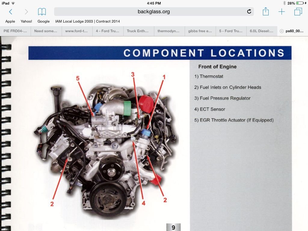

Err where is it?

Are your sensors the same? Local parts houses show 2 different part numbers for an 03 6.0.
Old Feb 16, 2015 | 11:16 AM
Bullitt390's Avatar
Bullitt390
Certified Thread Hijacker
Joined: Aug 2001
Posts: 14,441
Likes: 60
Both temp sensors are the same.
There is also the additional oil pressure switch.
Josh
