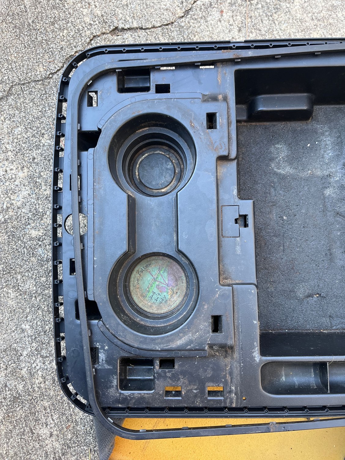

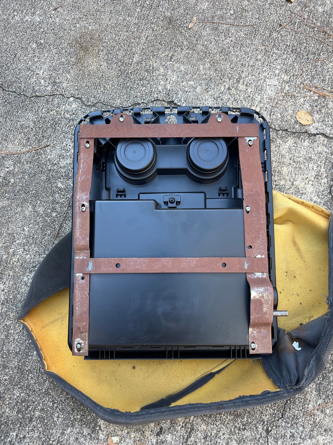

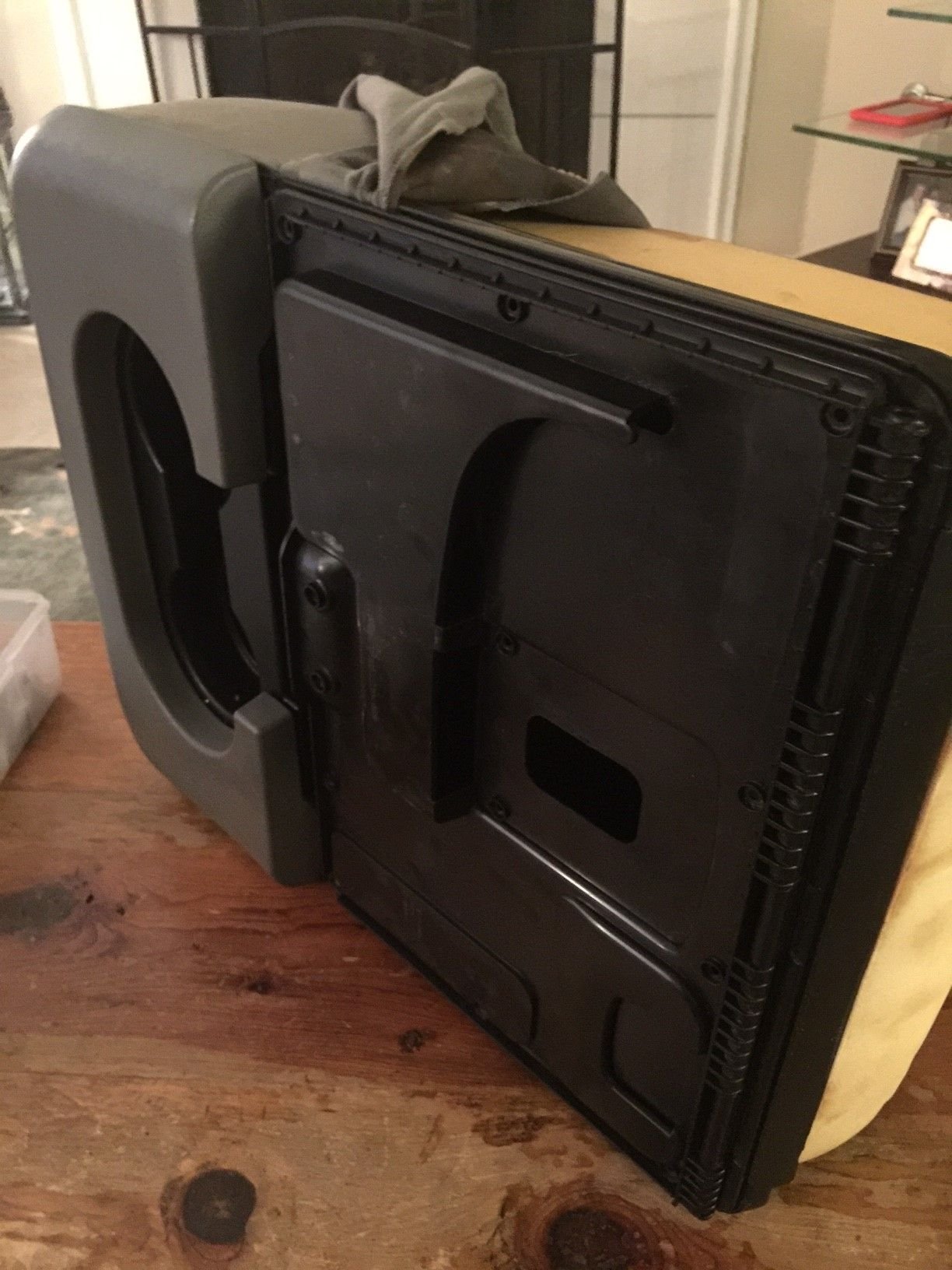

Little more info:
Disassembled center console
