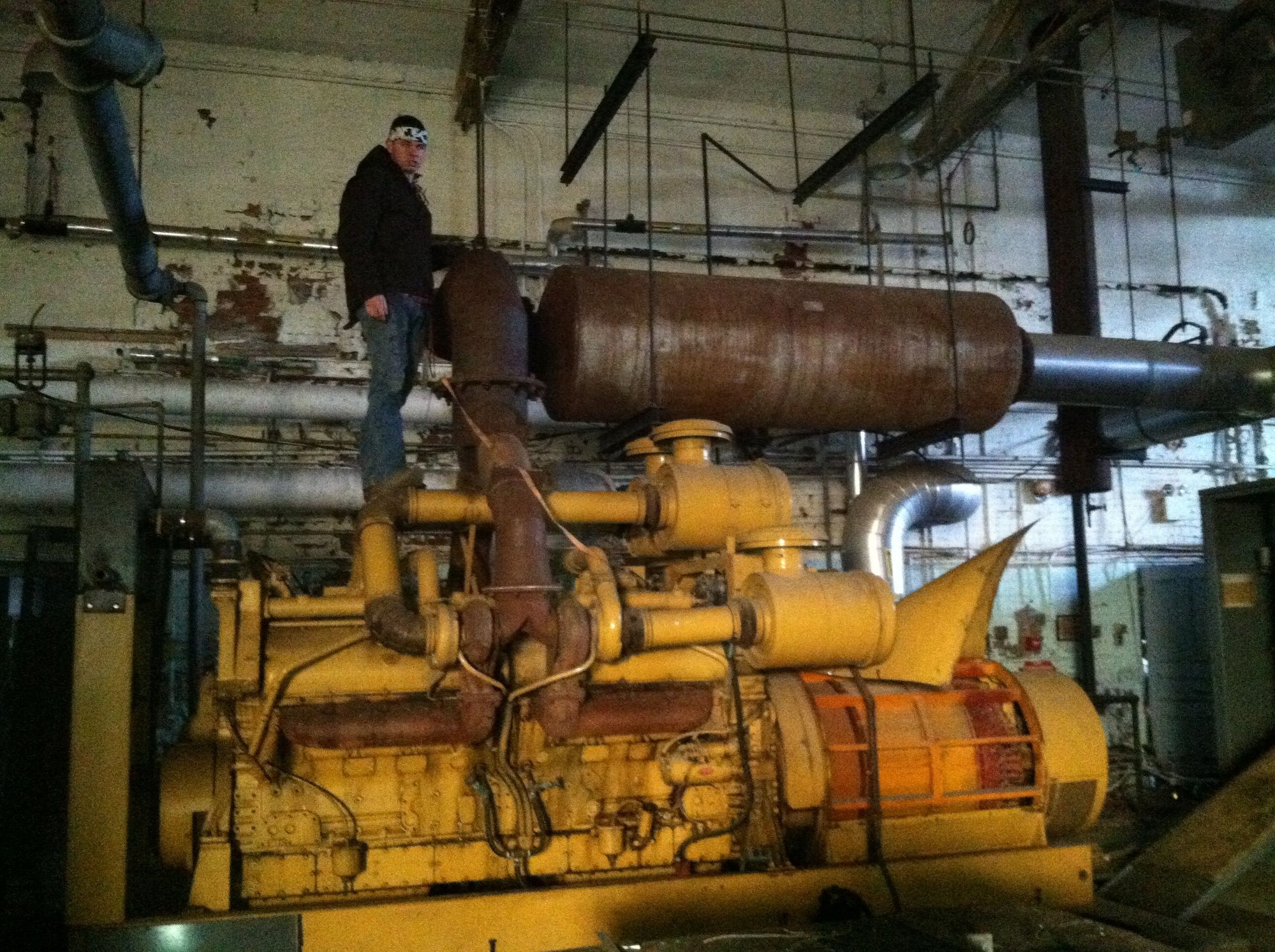

I was thinking and remembered there is an abandoned factory near where I live as this monster is there. It is a V16 with 4 turbos. I wonder if one of these turbos would work on an idi? At first I though there is no way it would spool it but then I realized something; that is a v16 with 4 turbos! So, each turbo is only powered by 4 cylinders, I think that a 7.3 could spool that. I don't know what that engine is, or how much displacement there is but I think it might be crazy enough to work. I know project smogie had one from a cat c7 I think? Racin, what do you think?
Dang, that is a huge beast. Not sure on the turbo, but it sure would be cool to see that thing running.
You're thinking about this all wrong. Forget just pulling a turbocharger off that thing, just get it running, pull the generator off the end of it, and drop the whole thing into your truck.....

In all seriousness... How much boost can I put into a stock 7.3? I don't want to spend several hundred dollars for head studs, that is my main concern. I tried to find an answer, but I have seen anything with a turbo needs studs, and also 20psi is still ok with stock engine. Of course anything else that would not hold up to a turbo let me know.
I am thinking probably about 12-15 psi of boost, will stick injection pump put out enough fuel? I don't think the turbos on that engine (does anybody have an idea what it is?) have wastegates; how hard is it to put one in?
