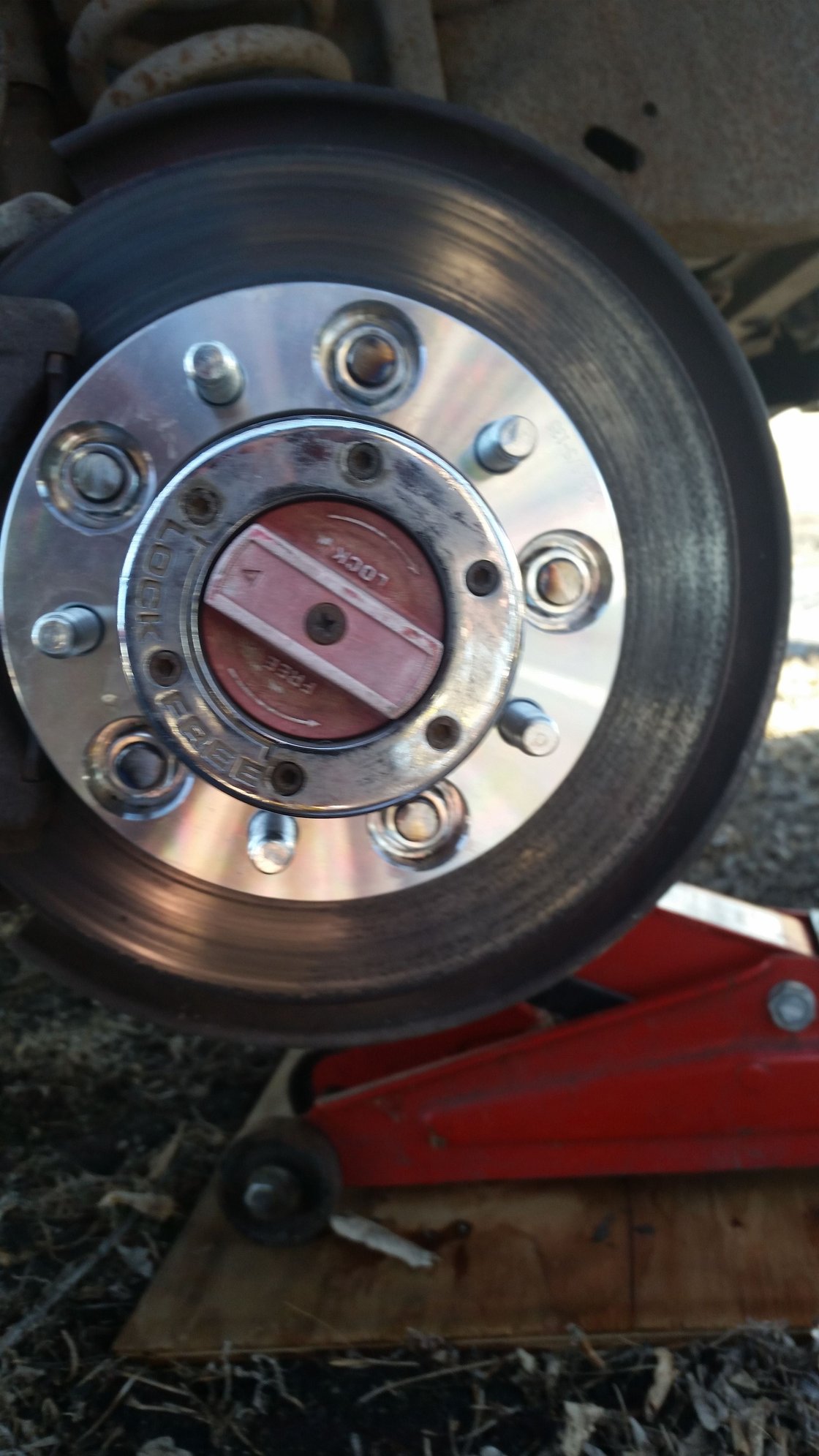

well my girl decided to spoil me a while back and just buy me adapters. the rims are 5x135. newer ford pattern. the issue now is my speedo. how do i figure out how many teeth i need on my speedo gear now? its a 86 302 aod tranny. current tires are 235 85 16s. at 2000 rpm im doing 78 according to my gps. i dont care so much about the speed problem as much as the mileage flying by on the truck.

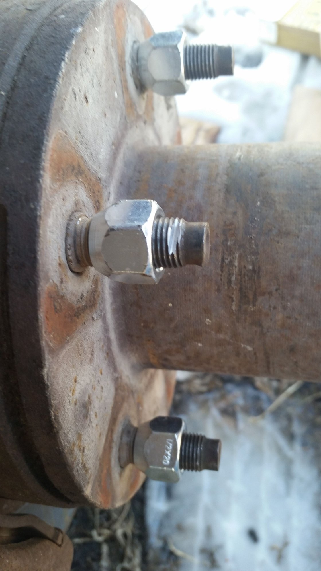

spin all lugnuts on

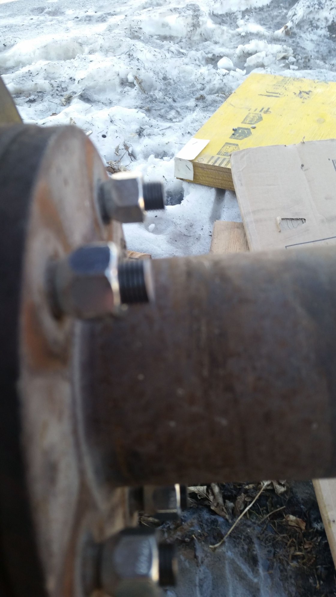

cut just the unthreaded portion of the stud off
make it nice and flat

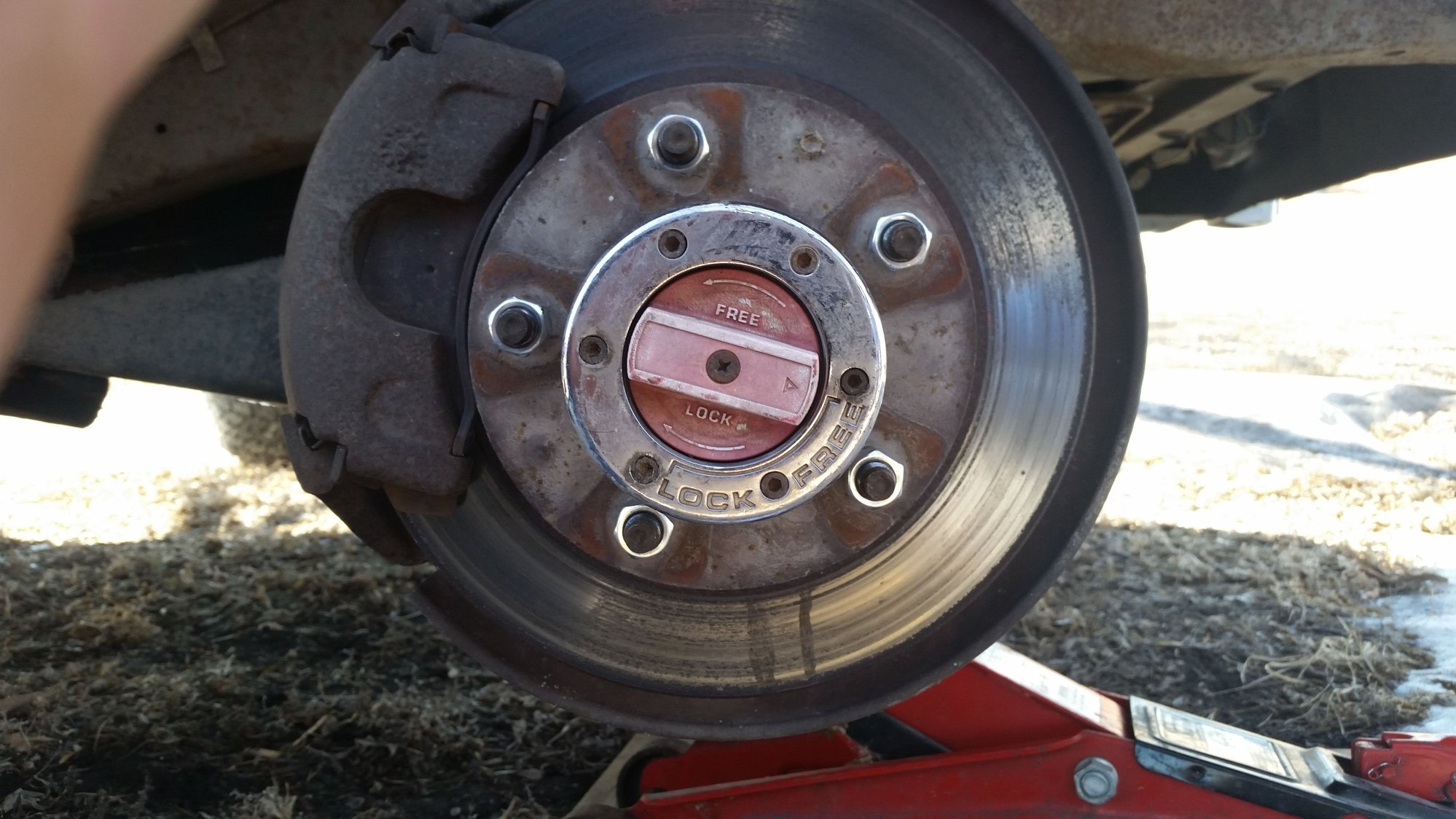

adapter installed. its 1 in thick
make sure none of the studs come past the adapter or your wheel will not sit flat and will get damaged

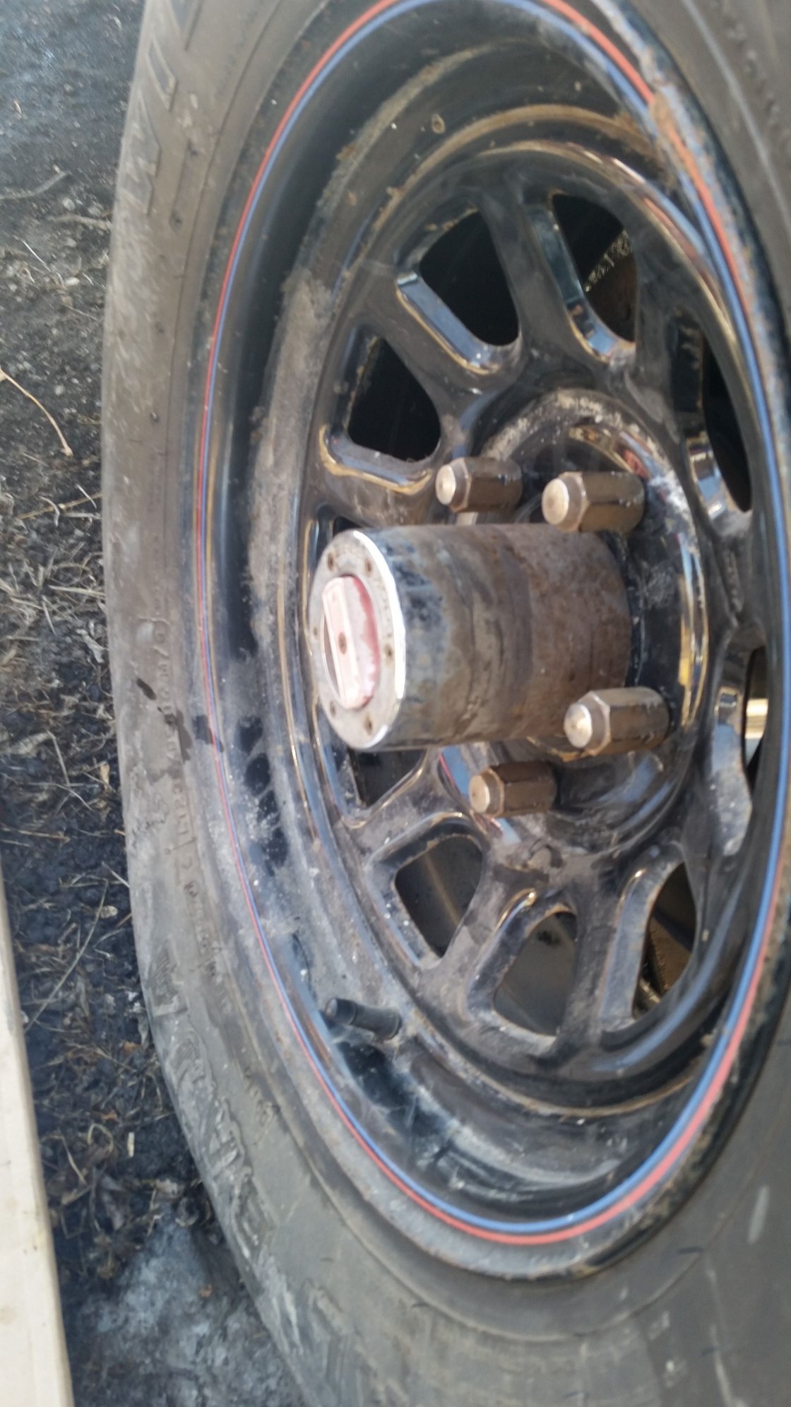

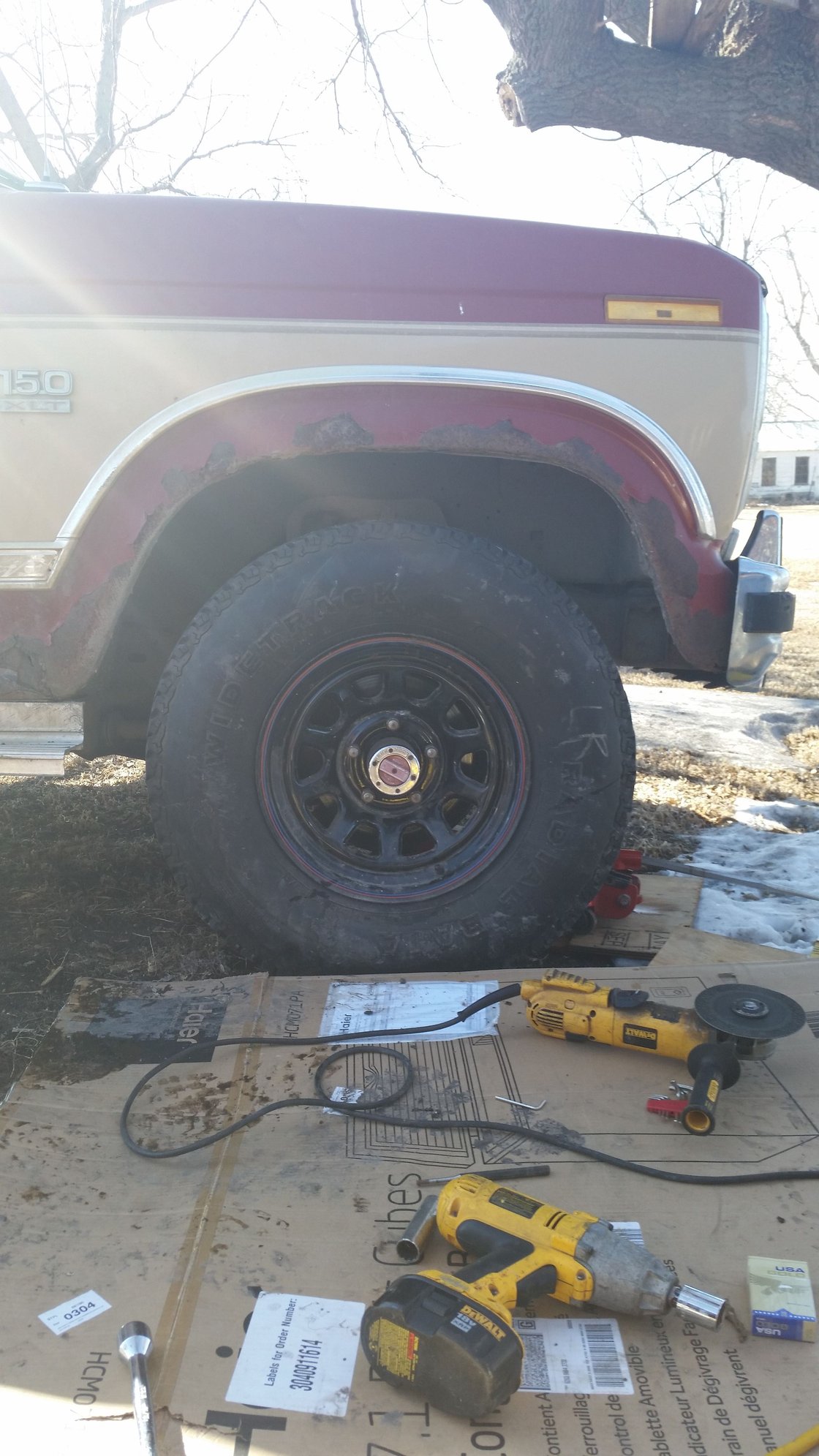

looks nice with tires pushed out a inch
Old Apr 16, 2015 | 10:43 AM
Franklin2's Avatar
Franklin2
Joined: Jan 2001
Posts: 56,992
Likes: 2,741
From: Virginia
Those tires are a little bigger than stock but not that much. How much is the speedometer off?
Old Apr 17, 2015 | 07:32 AM
f100beatertruck's Avatar
f100beatertruck
Joined: Apr 2003
Posts: 2,408
From: Parkesburg PA
They should be about 31-32" in diameter, so about 10% if I remember.
I used to have a list of gears, but I've got no idea where it's at. Try going up one tooth on the driven gear.
