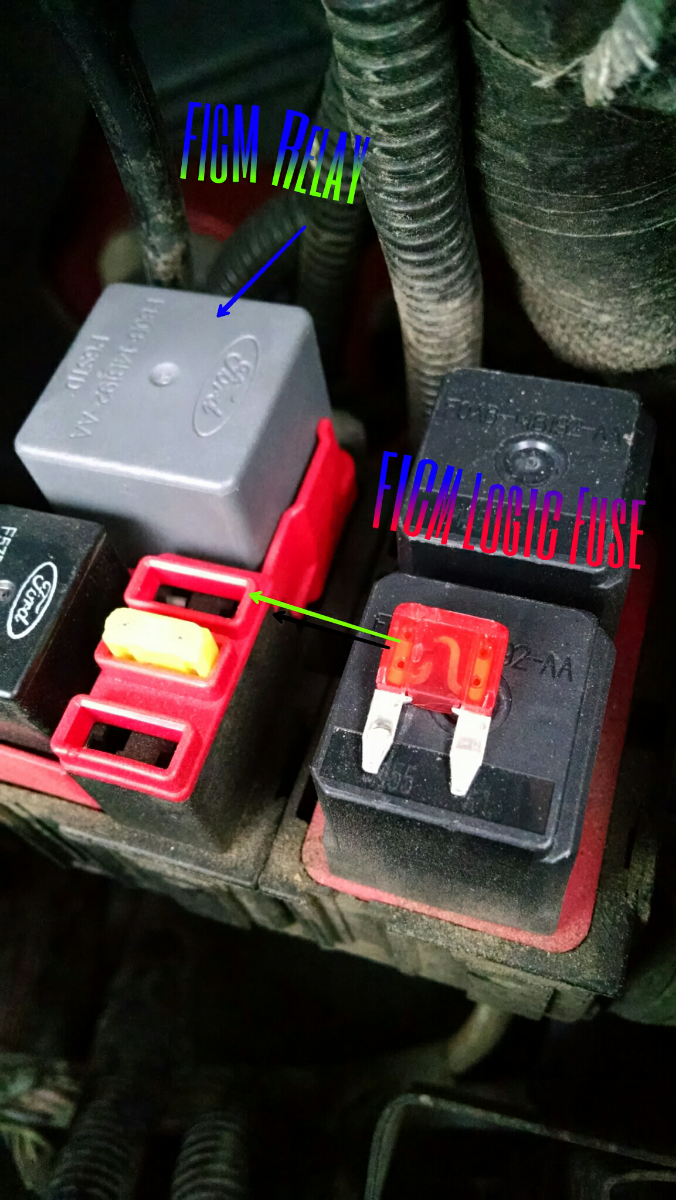

Which slot does the ficm relay go into? the cover says position 301,302,303, or 304.
This new relay looks like the other relays in those positions..
Your help is appreciated..

Labeled as IDM (Injector Driver Module) it relay 304 under the hood, front passenger side corner of the box on 2005+.
https://www.ford-trucks.com/forums/1...odel-year.html

On my 06 it was the 304. Hope this will help you.

For future search purposes, here's the early 6.0l FICM relay position. Underhood box, next to brake master cylinder.
