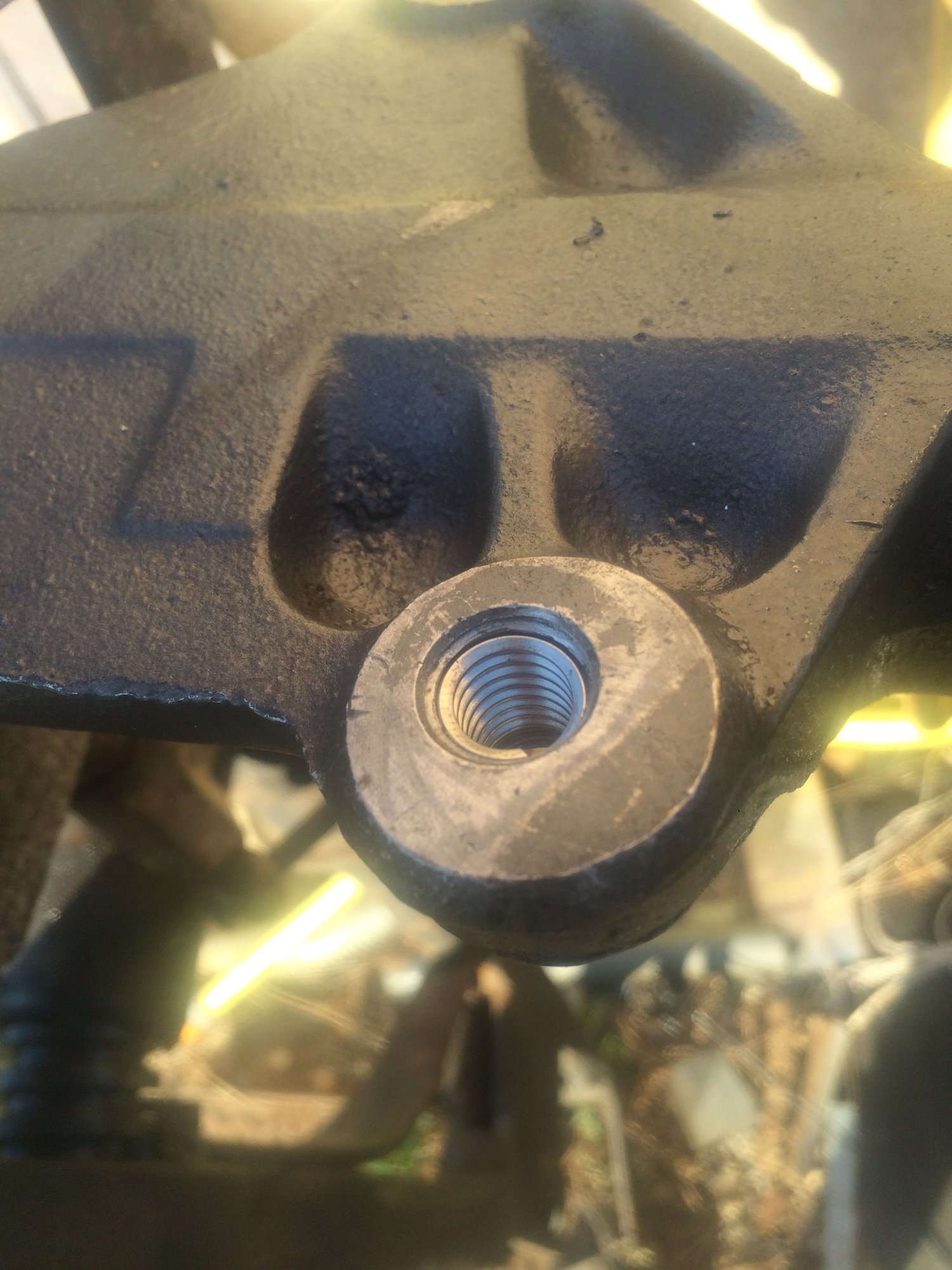

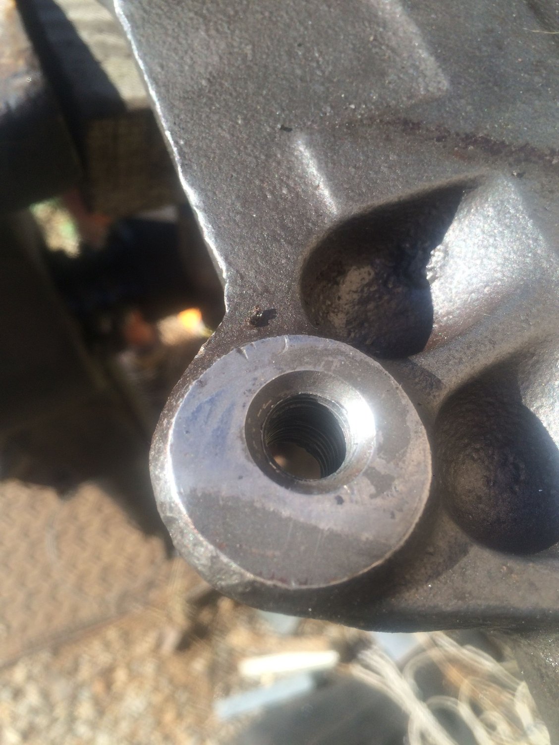

Hi! For those interested, here is how I solved my little problem:
Ordered online some Helicoil type thread repair kit while abroad and did the magic once back home.
You wouldn't believe how hard was to find the right bolts here in France...
BTW now it's fixed and solid.
Those self called mechanics that worked on that car are just criminals when you realise the size of the bolt they put (5/16) compared to the normal ones (barely half the section).
Here are some pictures:
