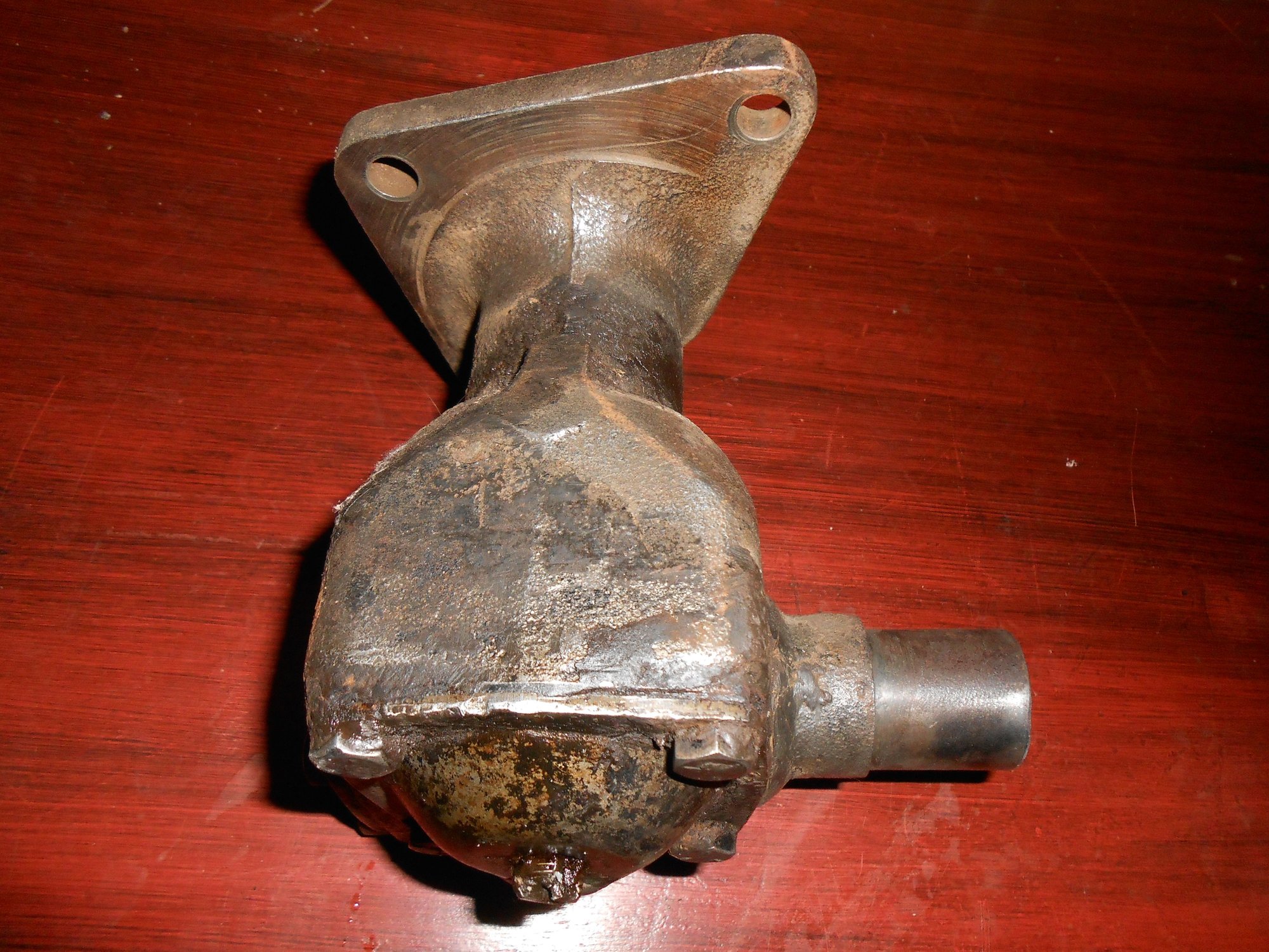

Good idea, first pic is showing me pointing to the box where the colmun overlaps. As compared to the other box you can see the difference

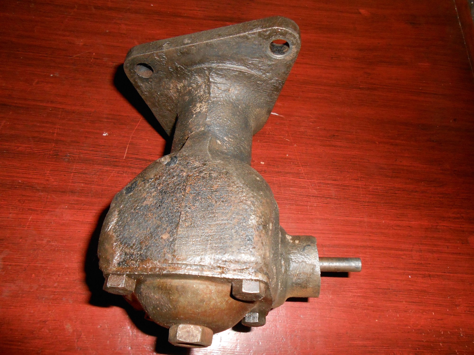

second pic is the cut off box that is useless

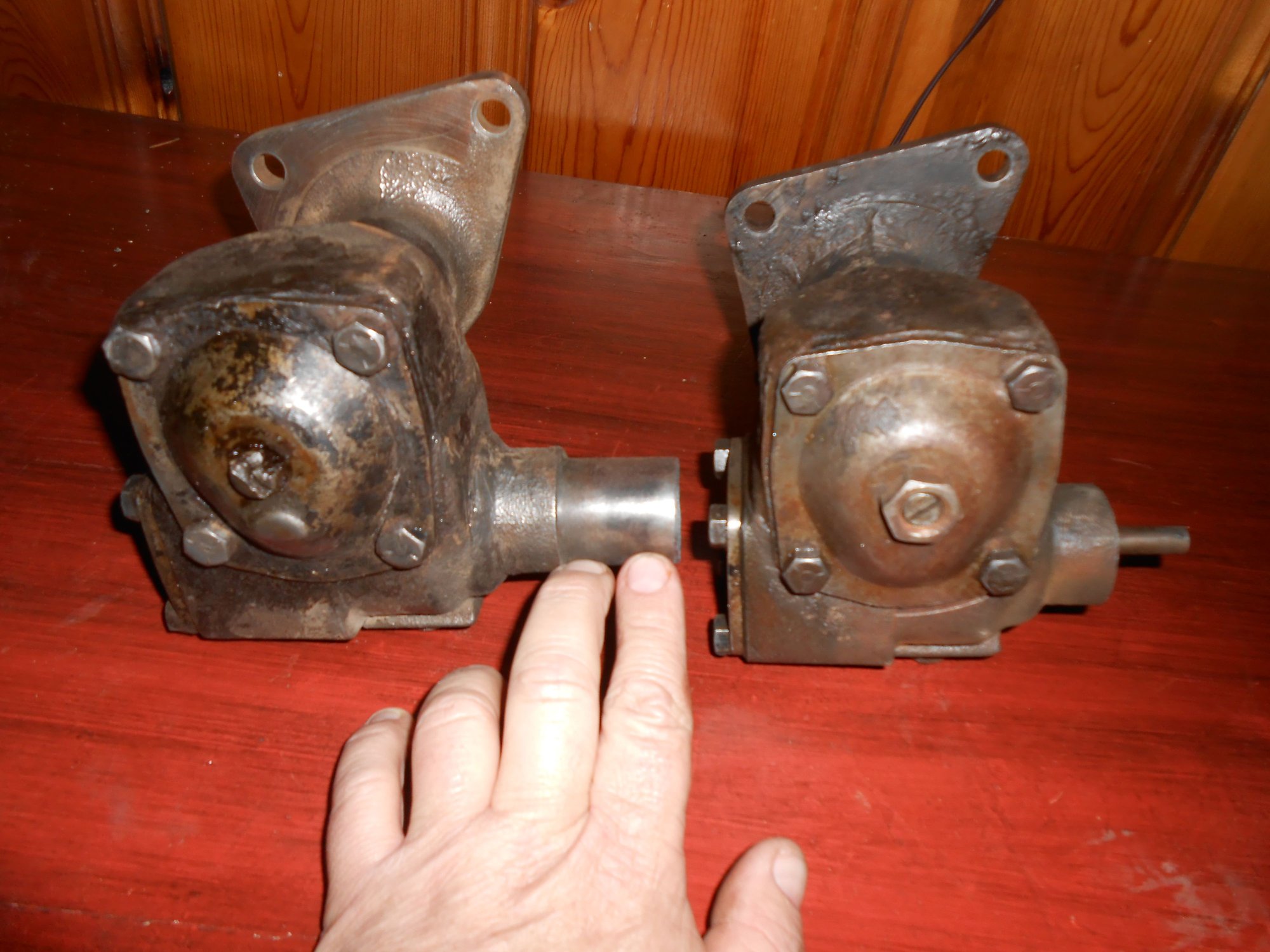

last pic what I will call a "good" box uncut, the column clamp must be removed and the column removed to access this, only then do you cut the steering shaft off leaving the box unhurt.
